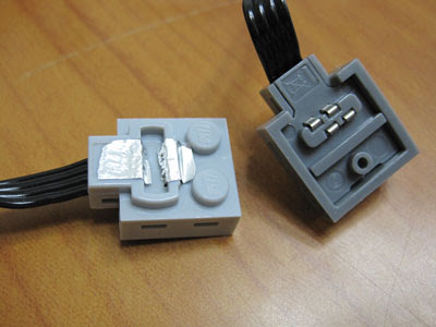

Actually with PF there are 4 lines; GND, +9V, C1 and C2. The voltage on C1 and C2 actually do the speed regulation, so in principle you could afford to drop two 10k resistors between the 9V and GND, and take an output between the two supply power to C1, but it would need a custom cable - (Philohome has more details on PF functions).

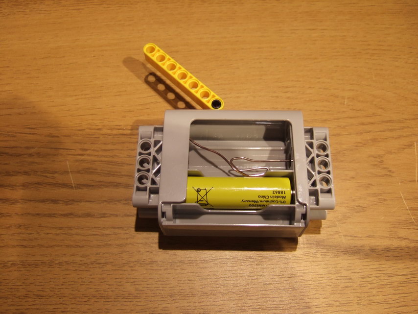

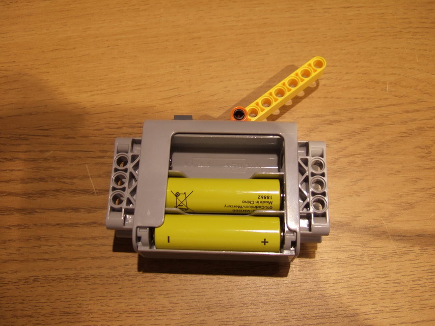

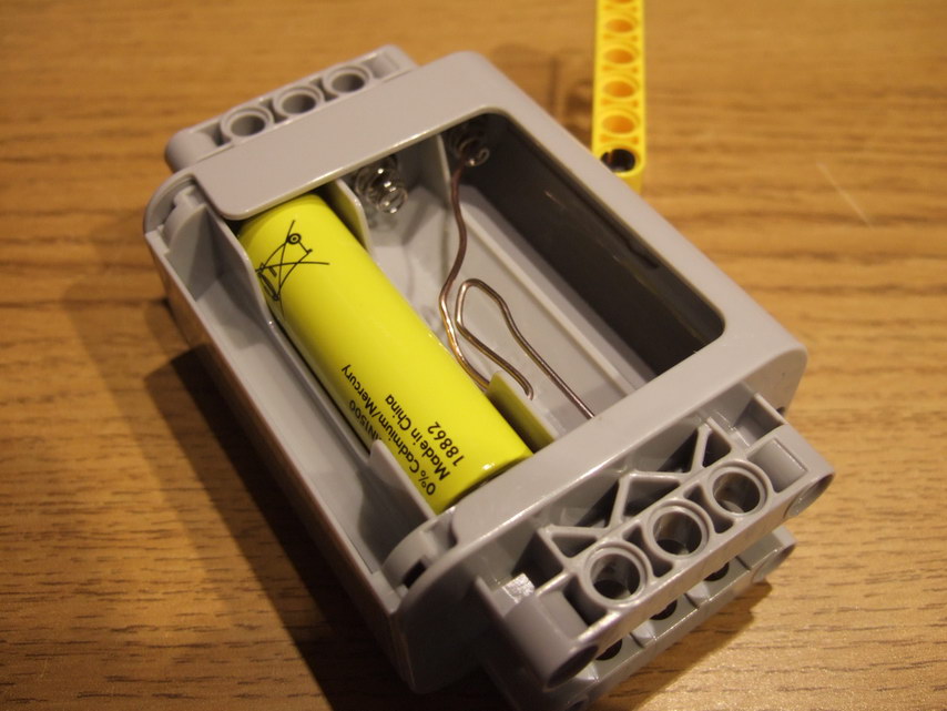

Thanks guys for all the tips.
I ended up taking out three batteries and shortcuting - a friend at work helped me an elegant solution with using a single paper clip set in tension between two poles. See below how it was done.
And IMHO, the way the Vestas turn now is the way it should be - more majestic and with a nimble electric whining sound.
Ah! the ubiquitous paper clip!!! very clever :wink:

The tricky parts was to figure out how the batteries are connected in serial in the batterbox, that's why one battery is left out on one side, and the papperclip is crossing over two battery compartments on the other.
But the alumnium covered battery I really like. Simple and elegant. I'll probably use that method the next time.
