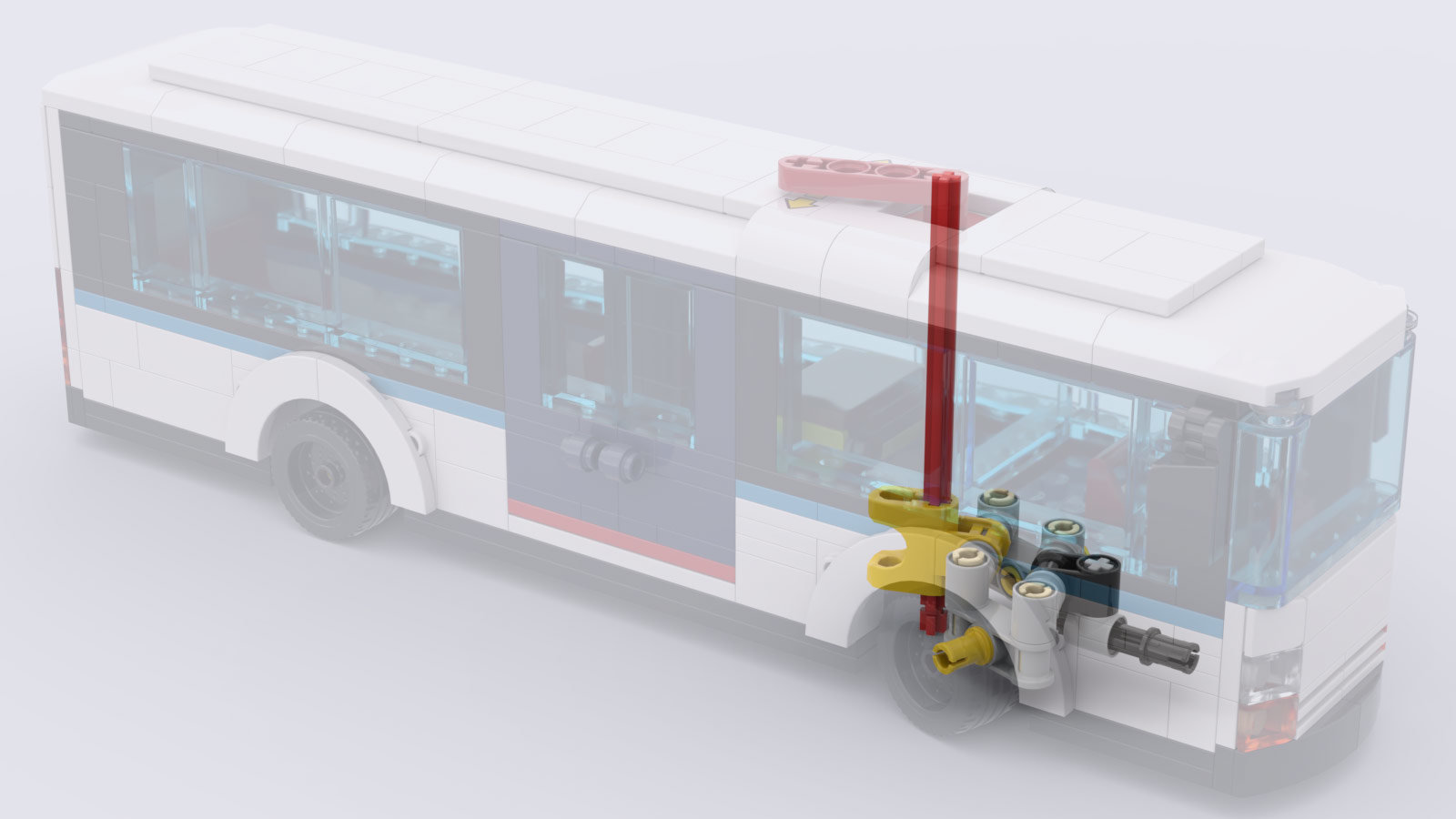

stevendejong Posted June 29, 2023 Posted June 29, 2023 Hi everyone, I'm reviving an old topic because I think I might have something to add. :) I've designed an operable virtual pivot steering mechanism for 6-stud cars. I'm attaching an image of the mechanism inside a bus. Notable (I think) is: The mechanism does not rely on tolerances in Technic. The parallellogram slides along an axle. The wheels are not rotating exactly around their own z-axis, but the rotation point is close enough. In theory, they could rotate within the gap of a Lego mudguard such as 35789. Unfortunately, pretty Lego mudguards have a wall on the inside, preventing the wheel from rotating inward and blocking the possibility to add a mechanism there. This is why the bus has brick-built mudguards. Full gallery and annotated close-ups:https://bricksafe.com/pages/stevendejong/virtual-pivot-steering-for-6-stud-vehicles My Rebrickable page:https://rebrickable.com/users/stevendejong/mocs/ Quote
Jurss Posted June 29, 2023 Posted June 29, 2023 1 hour ago, stevendejong said: I've designed an operable virtual pivot steering mechanism for 6-stud cars. Interesting idea, but have You built it for real? Quote
Zerobricks Posted June 29, 2023 Posted June 29, 2023 (edited) 13 minutes ago, Jurss said: Interesting idea, but have You built it for real? Exactly, those connectors held by half a stud will instantly fall out due to the rounded edges. BUT you can use 41678 instead of half bushes and it should stay together. Edited June 29, 2023 by Zerobricks Quote
gyenesvi Posted June 29, 2023 Posted June 29, 2023 36 minutes ago, Zerobricks said: Exactly, those connectors held by half a stud will instantly fall out due to the rounded edges. BUT you can use 41678 instead of half bushes and it should stay together. Same thought here of them falling apart, though they might work for a while in a light-weight vehicle on flat surface when the parts are new.. But I wonder how you would use 41678 here? The only reasonable space I see putting them is upwards, otherwise they'd block the mechanism, but the floor of the bus is there, not leaving enough space upwards either. BTW, interesting idea for a small build like that! I guess the steering axle becomes reversed, that's why a lever is used instead of a gear? Quote
stevendejong Posted June 29, 2023 Posted June 29, 2023 Thanks for the incredibly knowledgeable feedback. Unfortunately I haven't been able to try the mechanism yet. Yes, those connectors are a potential issue. My problem with Technic is often that I know what I want to do, but the pieces are simply not available. :) That also explains why I am using the yellow ball connector; it's the only piece with two perpendicular axis holes. The suggestion to use 41678 is useful, but we end up with two pin holes for our rotation point instead of one. If anyone has a solution, please don't hold back! And yes, the steering direction is reversed wrt the steering axle. There are arrows under the lever to indicate the direction the vehicle will travel if you move the lever towards the arrow. Quote
vascolp Posted June 29, 2023 Posted June 29, 2023 Cool idea. I am also afraid it might not be strong enough. But if you use two sliding axles instead of one, and this part, it will hold. You will probably have to use two of this to attach the sliding axles. Than you have to brace it very well... Good luck! Quote
stevendejong Posted June 30, 2023 Posted June 30, 2023 (edited) Quote Cool idea. I am also afraid it might not be strong enough. But if you use two sliding axles instead of one, and this part, it will hold. You will probably have to use two of this to attach the sliding axles. Than you have to brace it very well... Thanks for the feedback and suggestion. I don't think I understand how to attach the steering axle if I use two sliding axles. Also, the parallellogram needs to rotate with respect to the sliding axle. Would you be able to provide a screenshot / render? Edited June 30, 2023 by stevendejong Quote
stevendejong Posted June 30, 2023 Posted June 30, 2023 (edited) A potential solution for a stronger build would be to make the parallellogram 5 studs instead of 4 and to attach thinner wheels. This has some disadvantages though. Reduced steering angle, approximately 15 degrees instead of 20. See red lines. Wheels are not turning around their own z-axis. They don't touch the chassis or mudguards, but steering looks less aesthetically pleasing. See green intersection. Those thin wheels and tires are less cool. :) Edited June 30, 2023 by stevendejong Quote
