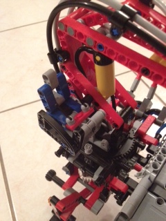

Hi every one
I have been improveing the air compressor of the mog.
Now it features a dual compressor still using the new air pumps and with the same gearing. That can achive a pressure of 250 kPa(2,5bars) until the PF-M stalls.
But it can only get the pressure uptil a about 160 kPa when there is a air tank between the compressor and the lego analogue pressure gauge.
What setup do you think the give the best playablity?
There simply isn't any other way of moving the lower pivot closer to the wheel than to use 2 pivot arms. That's why it had to be done. I agree that it's not 100% realistic, but it's much closer to the reality of vehicle design, than the lego version.
A small update on my unimog upgrade. The pneumatic is still a dual compressor, but last evening I managed to mounth both a pneumatics cylinder(for tipping of the bed) and pf-xl(same place as other have recommend and used) in the back of the truck. This evening (re)built, I spend on undoing a change that call for the driveing pf-xl motor to be placed where the fake engine is. And as if that wasn't trouble enough I also got placed a pf-m in the cabin to control the steering.
The status of of progress is that, it can drive fine. The tipping of the bed has rather not so small problem that when rising the cylinder to tip the bed the cylinder won't raise it just expanded backward. I highly suspent that to because of that cylinder is placed one stud more back than where others have place it.
The steering is extremely slugish but I am gonna implement LPEPower's design for an improved steering befor I make a assessment of it. Hopefully befor the weekend if the parts from BL comes in the mail:cry_happy:
And oh, are there anybody that has a good idea how make the cylinder climb upwards instead of backwards and breaking the truck? I has consider helper springs but hasn't tried that yet.

nicjasno / LPEPower I have tried youre improved front wheels suspension and steering setup and combined with the ldd post for several pages ago on how to a pf-m along with a slip gear. It will say that it works much better than tlg design:thumbup:
Anyway I made with my parts. But the younger kids, in my family loved it when I showed them my improved unimog.(Maybe I will do photoshoot and a video of it, with my windows phone later this week).
But is there anybody that has problem with gears slipping, 'gearbox' just behind the wheels. I uses a 8 + 24tooth gear resulting a ratio 1:3. But I still have the problem on the left front wheel the gears sometimes slips a lot. And I suspect it because the gears are very worn down.
This could also be, because the universal joint does not fit snugly into the top hole and allows the gears to slip under load. This can't happen with the LPEpower sollution.
I am using your idea, so either it can happen or the gears are worn down. And I don't have to time to test it, befor after the weekend (Come to think about it I am not sure I got replacement gears, not used in display models).
Can you make a pic of those worn gears?
Sure, but give me a couple of days. Anyway as far I recalls, the gears got worn in a really old rcx rubber band tracked tank. I uses for some kinde of robotics class codeing a bit assembly for the 8-bit chip:tongue: , anyway the story was that there was a small tournament for the student and the tank had few enginen timing problems.
