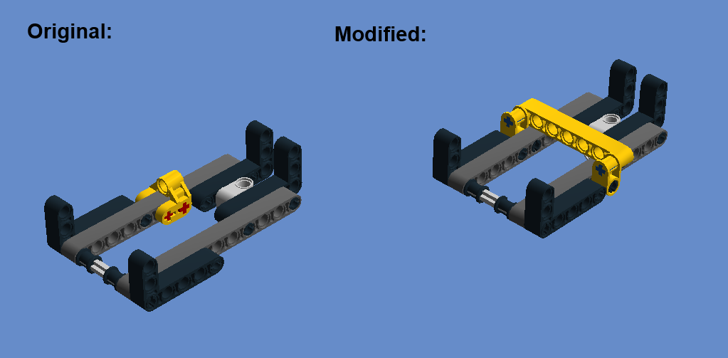

reibuehl Posted May 28, 2013 Posted May 28, 2013 Hi all, I was wondering if somebody here could give me some advice for a modification to my 8110 that I am planing: I would like to drive the rear PTO with a separate remote controlled M motor. The motor would fit nicely in the rear part of the frame except for the connector that is used to connect the panhard rod to the frame. I think this is a 92907 connector. I am now looking for a clever and stable solution to attach the pall pin for the panhard rod in a way that does not require any space on the insight of the frame. Reiner Quote

reibuehl Posted May 29, 2013 Posted May 29, 2013 Turning it around will not help as it is the inner part that blocks the space: I need something that is fixed to the outside of the dark gray liftarm and does not consume any space on the frame inside. Quote

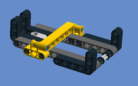

jovel Posted May 29, 2013 Posted May 29, 2013 (edited) @reibuehl Use thesewith a 3x5 L beam and a 1x7 beam to connect at the other side with Edited May 29, 2013 by jovel Quote
reibuehl Posted May 30, 2013 Posted May 30, 2013 @jovel: I think your idea is more stable - I will modify mine with your recommendations: Quote
