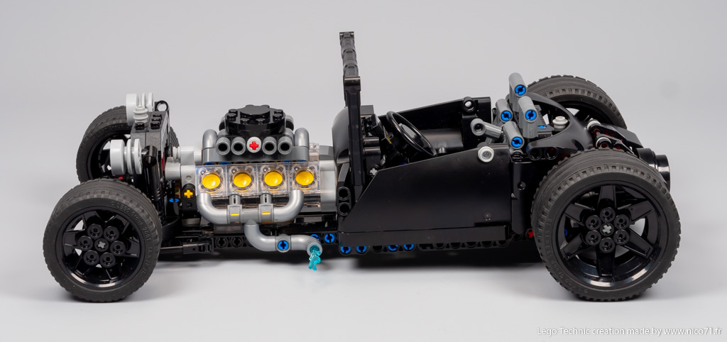

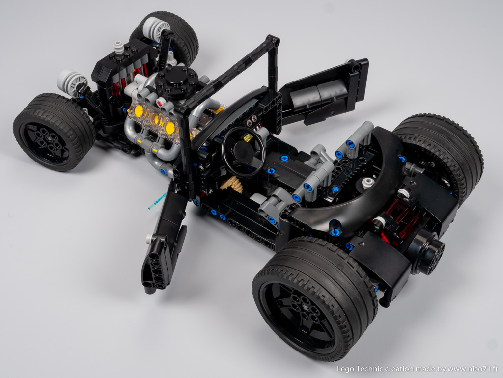

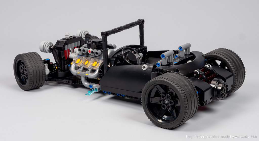

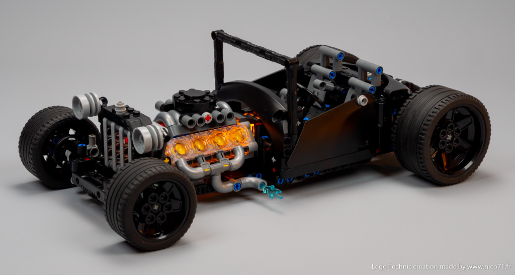

An alternate model of the 42127 – Batmobile , as a Bucket Hot Rod. Features, steering connected to the steering wheel, RWD with fake V8 engine, opening doors, removable hard top, and light bricks in the engine and on the rear light, with building instructions.
Context
When the 42127 – Batmobile, was announced, it was a “meh” for me. Nice looking (especially the front) but a lack of functions for 1359 parts set : no suspensions, no working steering wheel, and of course no B model. The light bricks are cool features in Technic but the rear one is failed for me, as it is too far from the engine to illuminate correctly. That is why I wanted to make an alternate model of this set. There were not many options because of the different sizes between the front and rear wheels, so I chose to make a Bucket Hot Rod, in order to have a removable roof, for a better accessibility to the steering (and nice look too).
Functions

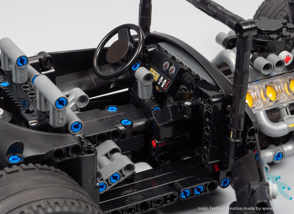

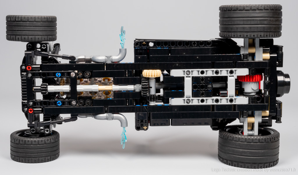

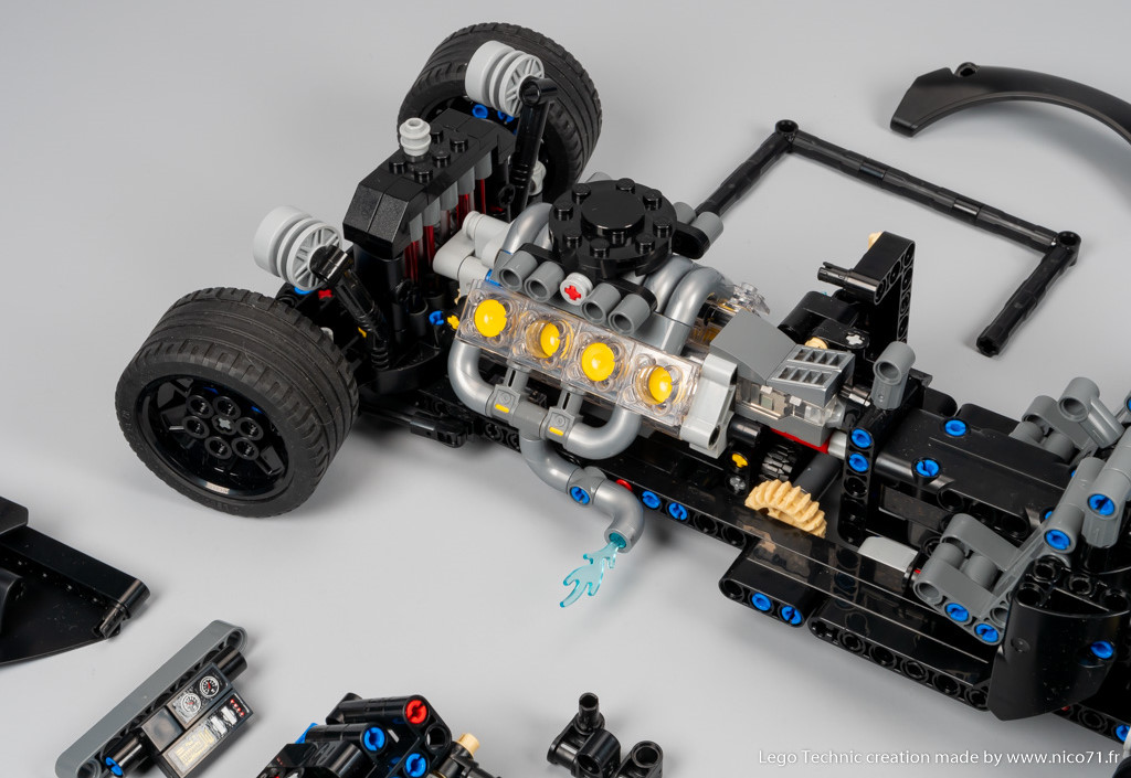

The steering is made using a classic rack and pinion solution, but I have put the pinion underneath the rack to have the steering axle as low as possible in the chassis to keep a low profile for a better looking. Then the steering axle goes to double bevel gearing to put the axle horizontally on the left. Then a U-join is used to connected it to the steering wheel. I had not enough place or clutch gearing to add a HOG so I decided to keep only the connection to the steering wheel in order to have a correct construction.
The drivetrain is rather simple. The rear differential is connected to the engine with a straight axle which crosses the entire chassis and interior. Due to the difference of size of the tires, I have put the rear axle higher to keep good proportion regarding ground clearance which made it visible in the passengers area. That is why I have hidden it under a central console which also acts as the reinforcement of the structure.

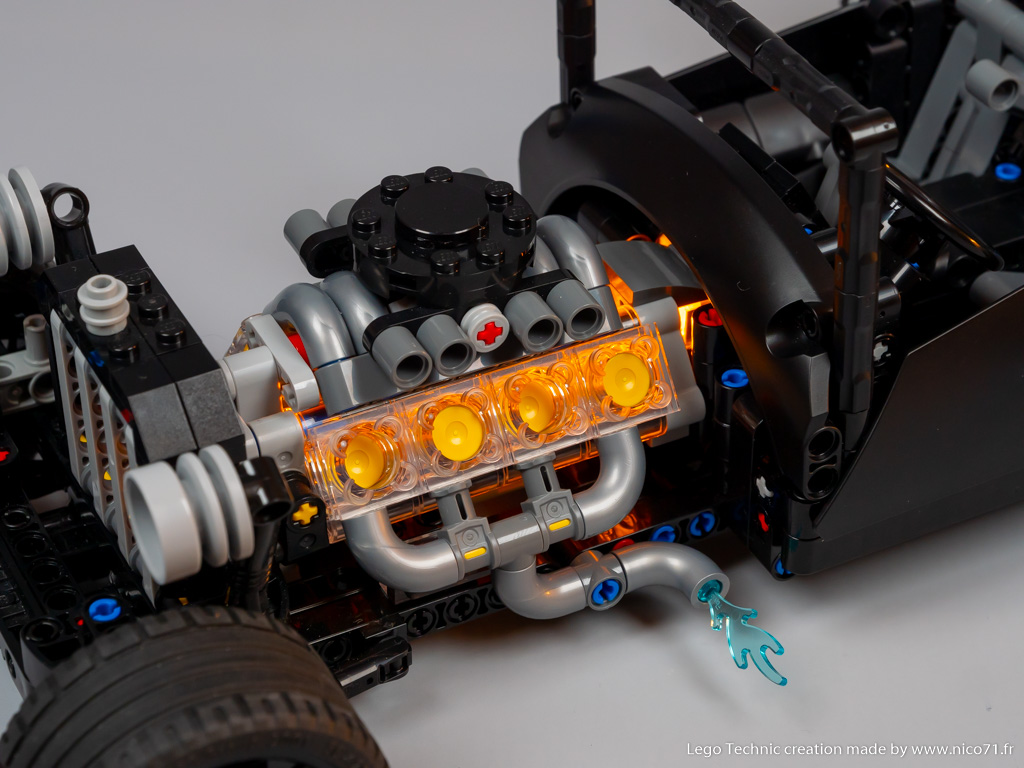

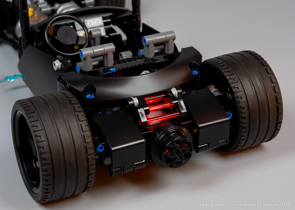

The lighting functions are interesting. I wanted to have a better illumination of the engine than the original model, that is why I have chosen to use the yellow light bricks on the engine which is stronger, and keep the red one for the rear lights. I have used this part on a side of the engine, where the light is, because it has a massive central hole which enables to illuminate the engine easily though the transparent material of the cylinders. Then, I have placed the light bricks on the correct height and as close as possible to have the best illumination possible. A lever placed on the center of dashboard is used to push the button on the light brick. The construction is made in a way that this lever is locked against the light bricks button when it is on, to ensure a constant functioning without having to operate continuously the lever (and a very satisfying clicking sound).
The rear lights are not properly multiple lights on each side, but more a central lights composed of the red transparent lightsaber, where the differential can be seen. The red light brick is located behind the seats, on the left of the differential, which results in a complex building with plates to have the correct height without touching the differential. The light power is lower as it is placed further, but as the lightsabers are transparent red, it is enough to illuminate them. The button of the light brick is operated with a small lever located between the seat with a friction pin to ensure a constant functioning.
To finish with more design functions, the doors can be open, revealed a detailed interior with dashboard (with use of the original stickers), seats and central console. The hard top can be removed to have a better accessibility to the steering wheel. I wanted at first to make a convertible roof, but I did not succeed with the parts, and in keeping the profile as low as possible. There were simply not enough room to store the convertible roof on the rear axle without damaging the look, that is why I have created a hard top instead.
Design Process
The design process is not very interesting regarding how I planed the model, but it is interesting in some building techniques. First I have started working on the front axle and a basic chassis, to have the lower profile as possible and scale the creation. Then I created the front grill which is an important and distinctive element. Then I created the engine with the light brick and its detail such as the intakes and exhausts because it has to look powerful. After that I reworked the chassis and created the rear axle and then connected the whole together. At this point, I have a pretty good idea what the model would look. I worked next on the steering wheel gearing and the interior, and to finish the rear details and light bricks. After some day, watching the creation and playing with, I have made some improvements, and it was done.
The first building technique is how I create the steering column. It has to handle the gearing and the correct angle of the steering wheel, despite the lack of any fixed connector. I have used this part on one side, and two of this part on the other side which was not easy to implemented on the whole assembly with the U-join and connection with the bodywork and the chassis. It results in a very dense and complex structure which I am proud of.
The second building technique is how I fixed the exhaust on each side. As you can see, there are attached to the chassis only with a friction pin and are locked on the engine. But it was not enough to prevent that they rotated under heavy playing. That is why I have used a construction with this part, which is placed recessed and underneath the elbow. This construction prevents the whole exhaust assembly to rotate, and as it is thin and dark, it is mostly invisible.
There are others small interesting building techniques that I will develop in the Design Secrets of this creation later. To finish with a global appreciation, I am very happy with the design of this creation. Even if the parts were mostly black which is useful for the design, the lack of connector and axle joiner, and even axle makes the design a bit tricky to avoid mismatched colors. But in my opinion, I succeeded. I am happy with the details on the engine, which looks powerful, and the use of certain panels to create interesting shapes, like the mudguard on the front bodywork and on the back of the bucket, but also this panel to create the rear shape. It gives a nice shape with a low profile vehicle which looks like making drag race !
This model uses only 842 parts on the 1359 parts which seems to be low, but this model is smaller than the original A model and have not a full bodywork, just a bucket bodywork, and open engine area. Despite that, it has classic but playable functions and nice looking with the lights on and several details, it is a great addition to the original model.

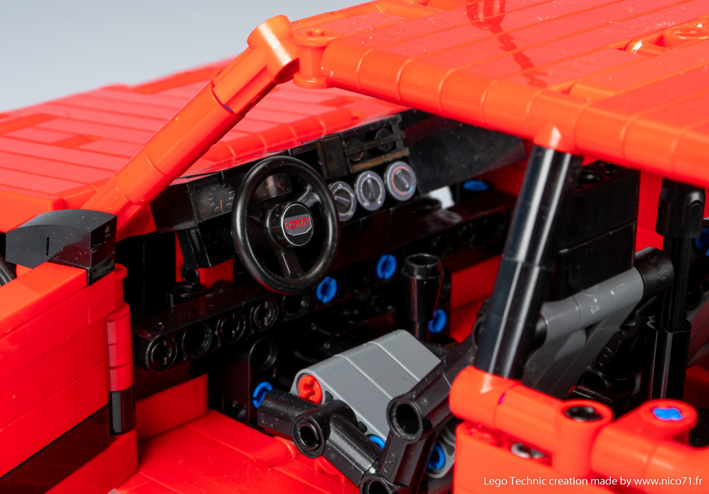

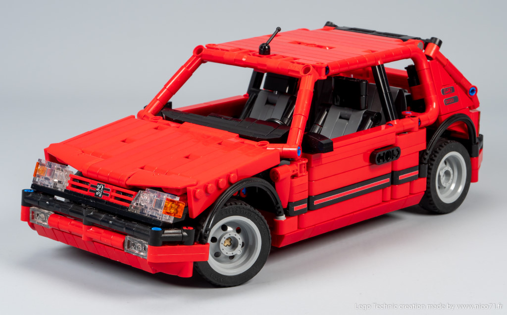

Peugeot 205 GTI
A Peugeot 205 GTI made out Lego Technic, featured suspensions, steering with hand of god, opening doors, trunk and hood, with detailed engine, interior and custom stickers. Available in three colors (Red, White and Black) with building instructions.
lego-peugeot-205-gti-1
Context
Creating a replica of the Legendary Peugeot 205 GTI was on my plan for a long time. After completing the Citroen 2CV and Mehari, I wanted to reproduce more car with the 43mm tires as I though this small scale fits well the purpose of this creation : creating a affordable and detailed replica of iconic car, in order to propose it for car enthusiast. I did it with the Fiat 500 and it’s now Peugeot’s turn to be replicated in Lego.
lego-peugeot-205-gti-3
This car is very iconic, especially in France. It was the answer to the Vokswagen Golf GTI from Peugeot. It came first with a 1.6l 105hp, then with a more powerful 1.9l 130hp for 880kg. Combining with a sport design with black trim, new wheels and GTI inscription, it makes a very fun car to drive and have strong performances for its time. The 205  is also popular thanks to the rally version, the T16. Peugeot drivers Vatanen and Timo Salonen won seven out of the 12 rounds to give Peugeot its first manufacturers’ title in 1985. You can see it in action, from a blessed rally time, with other very iconic car such as the Audi Quattro :
Functions

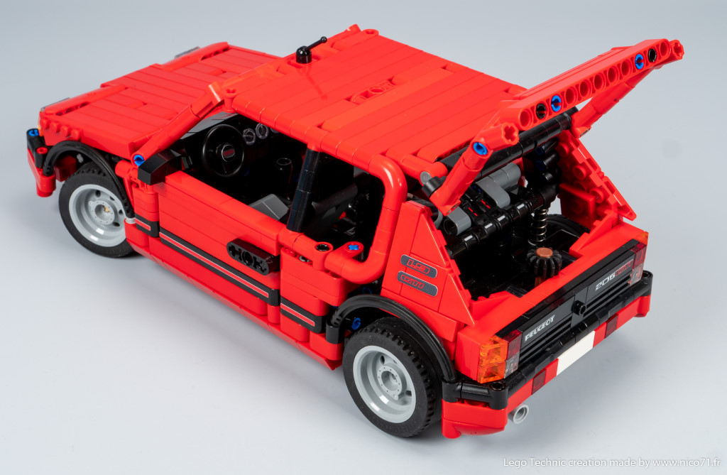

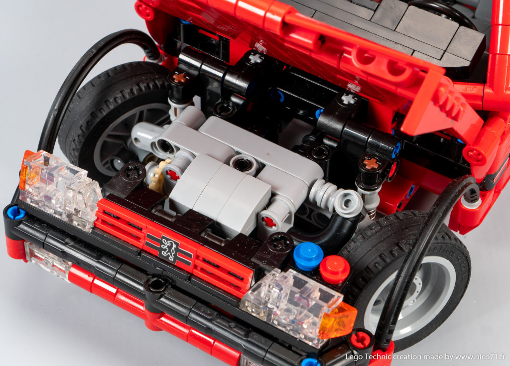

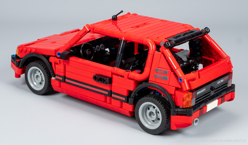

This tiny vehicle is packed with different functions, such as suspensions, steering, and openable elements. The front suspensions are double wishbones with dissembled spring from the 76138 parts, where the original car have MacPherson suspensions.  I have chosen this solution because of the available space, I could created a MacPherson strut but I preferred to tazke a simple solution to keep the price as affordable as possible. This solution, combined with the track width does not authorise to have a front drivetrain, that is why the engine is only for decorating. The rear suspensions are, as real, composed of independent trailing-arm with shock absorbers, which bring more space between, for the back seats.
lego-peugeot-205-gti-4=
The steering is fairly standard but differs from my previous small scale cars. Indeed, I can not use the classic solution (9l connecting rod) I have made on the Citroen 2Cv or the Fiat 500 because the track width were bigger. So I used two 6l connecting rod which connect to the same center pivot on the steering lever. Then, the axle goes in the chassis where a bevel gearing bring the motion to the Hand of God on the roof. I have not succeeded either to add a working steering wheel because of the available space, so I preferred to have a hand of god which is more playable. This hand of god can be removed easily from the roof to be store in the trunk.
lego-peugeot-205-gti-5

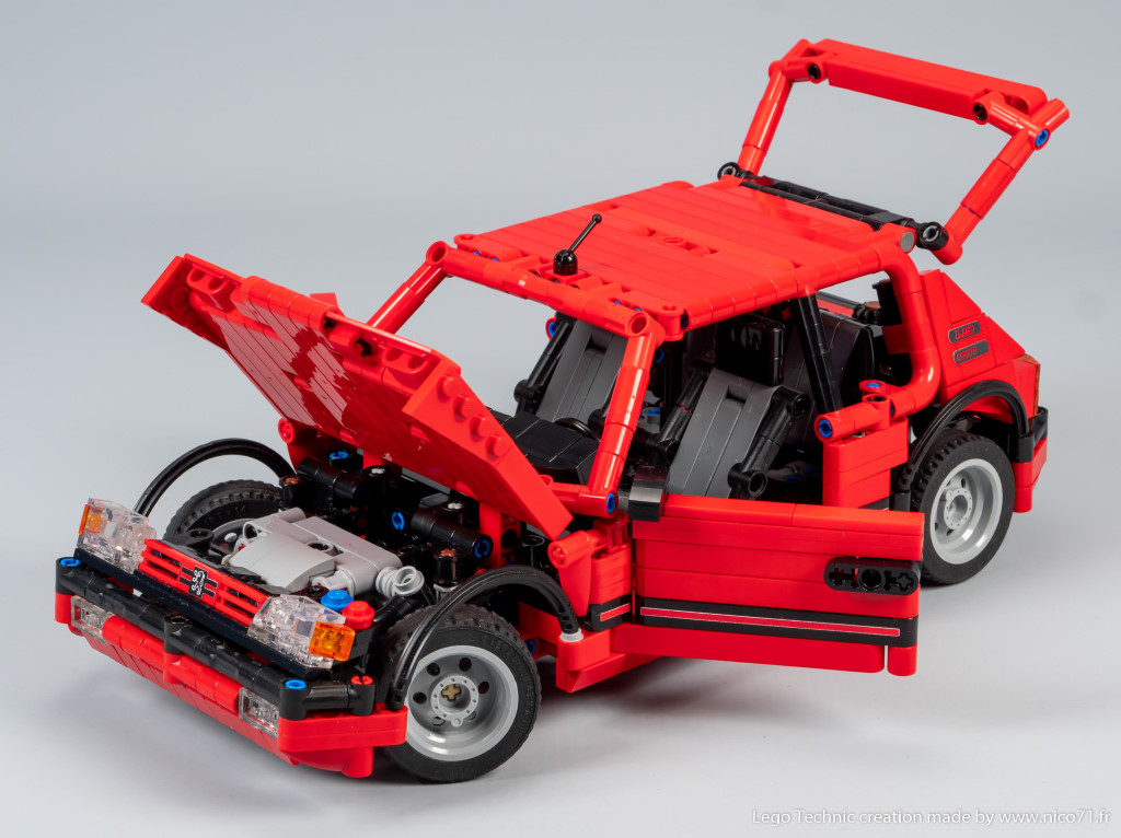

To finish with the functions, the doors can be open, revealing a detailed interior with seats, dashboard, back seats and the famous “red carpet”. The hood can be opened, revealing the (fake) detailed engine with the intake cover, cylinder head, and a battery. The trunk can also be opened to store the Hand of God.
Design
Even if the car is small in Lego Technic, the design was an important things. It had to mimic closely the iconic elements and the proportions to be recognizable, even at small scale. So I work on the proportions and their perception, for instance with a lot of cheese slopes to have the correct shape on the rocker panel, and the front and rear bumper.
The headlights were the most complicated things to replicate on this car, because of the particular shape of the front one, and the proportions of the rear one. The front one is composed of cheese slope in transparent to create the shape near the grill, and uses upside down headlight brick in transparent to fix the different elements. The rear one is more classic, using plates, slopes and tiles but are not exactly accurate to the original. They should be narrower and less height, but it is a compromise due to the Lego elements.
lego-peugeot-205-gti-6

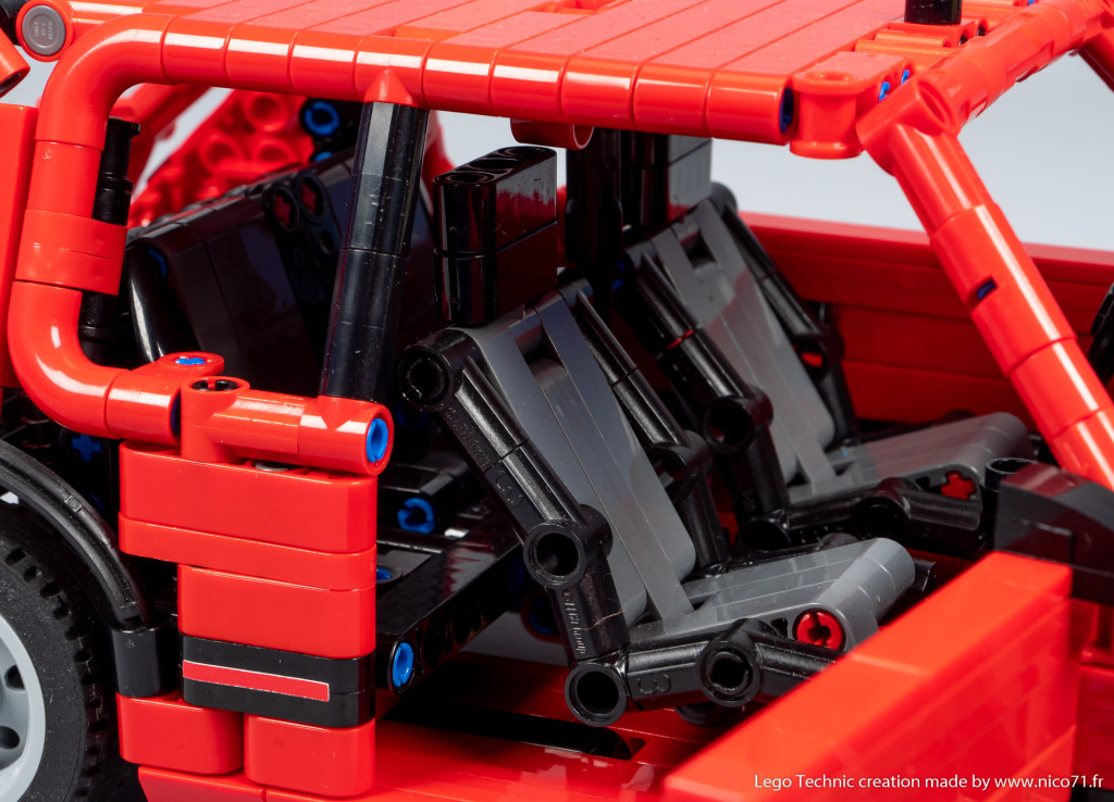

Since the Fiat 500, I work hard on the surface finish, to avoid the hole or strange pin/ axle color. For instance, I used tiles to cover the holes, or chose the correct orientation of the connectors and beams to have clean and smooth surfaces (on the roof for instance). As the scale is small, it has to be as clean as possible to avoid the distraction to recognize the car. That is why I used elbowwings and tiles on the C pillar to have the correct shape.
The interior had the same approach. As I could not reproduce the details only with technic parts, I used plates, tiles, slopes etc to create the correct shape. It is clearly visible in the dashboard for instance. It is one of the reason why I can not connect the steering wheel to the steering arm with a strong building so I preferred a more detailed one.
lego-peugeot-205-gti-7
To finish, as I did for my Honda S2000, the car is covered with stickers. With the help of Forwart Sticker, he created a custom sticker sheet which fits very well the exterior of the car, with Peugeot emblem on the front and rear, GTI logo for the side, side strips, and even two stickers to choose the size of the engine (1.6 or 1.9). The interior has also some stickers, with a dashboard, wheel steering GTI logo, and three vents controls, based on the 1.9 interior.
lego-peugeot-205-gti-8
There are some things which could be better as explained before, but I am very satisfied with the design and the functions of this car. The sticker helps a lot for sure, it brings the final touch to have a nice and affordable scale model of the Peugeot 205 GTI.
Pictures and Video
Dimensions : Scale : 1/13.5, Wheel : Ø43mm, 28cm (L) x 14cm (W) x 11.5cm (H)
Purchasing the creations or the instructions
As the previous small scale vehicle I did, of course I have to create building instructions, but I wanted as usual to propose different colors, that is why I have created three different versions based on the available parts and color : red, white and black. These versions are proposed for sale at Buildamoc in a complete package which includes the Lego genuine parts, the building instructions in a PDF, and the sticker sheet. You can only purchased the instructions if you want on my website (see building instruction section below).
Building Instructions
The instructions are 132 pages, for 985 parts, step by step high resolution (300DPI) computer generated instructions with partlists, flexible parts, part annotations, in the same way as the official Lego one. In my quest of making better and better instructions, I have included this time the sticker in the instructions to shown where to apply them. They are tiny so I recommend to use a small pliers and to not shaking ! You can buy the sticker sheet on Forwart’s Store.
Regarding the bill of material, you can checked the exact bill of material for each version on Rebrickable and export in whatever format you want :
You can buy the instructions on my website : https://www.nico71.fr/peugeot-205-gti/
Fell free to comment, ask questions ! I would be happy to read your feedbacks 🙂
Edited by nico71
