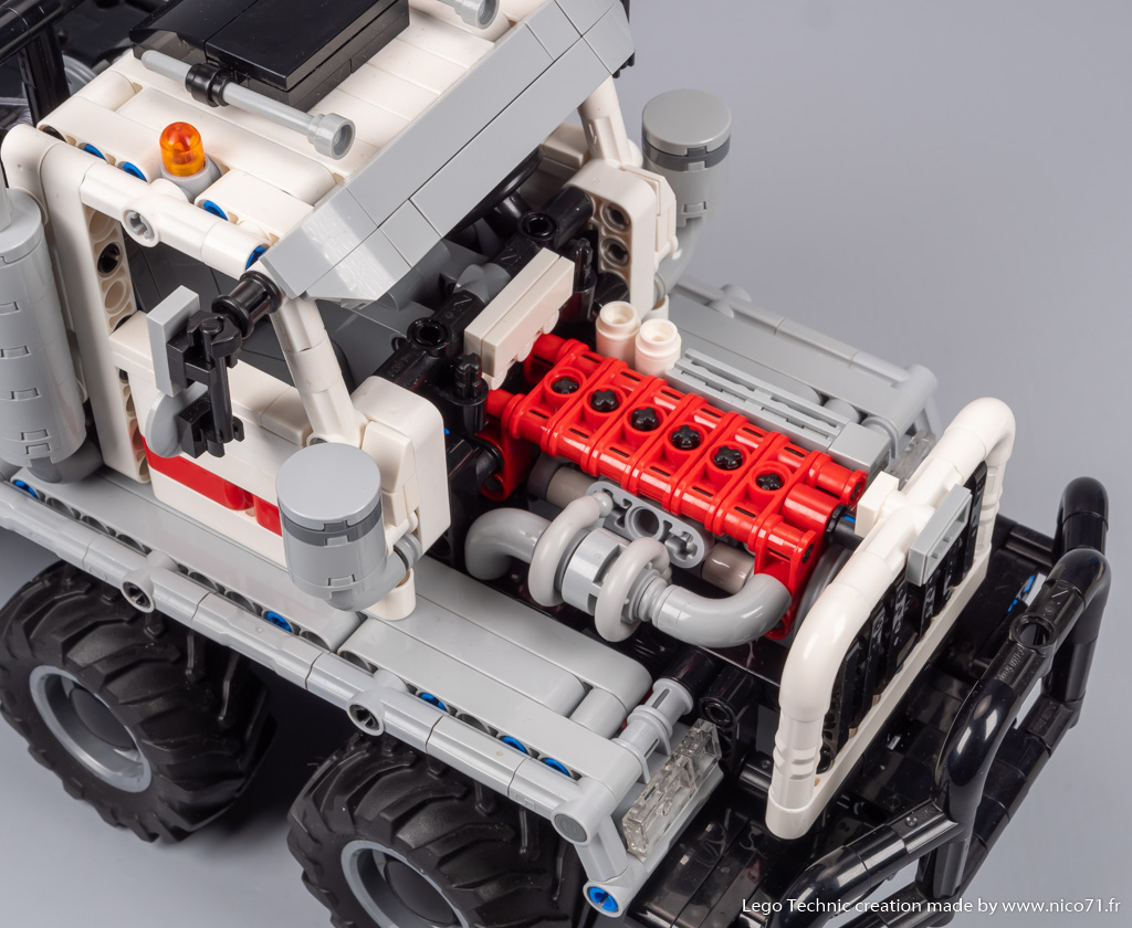

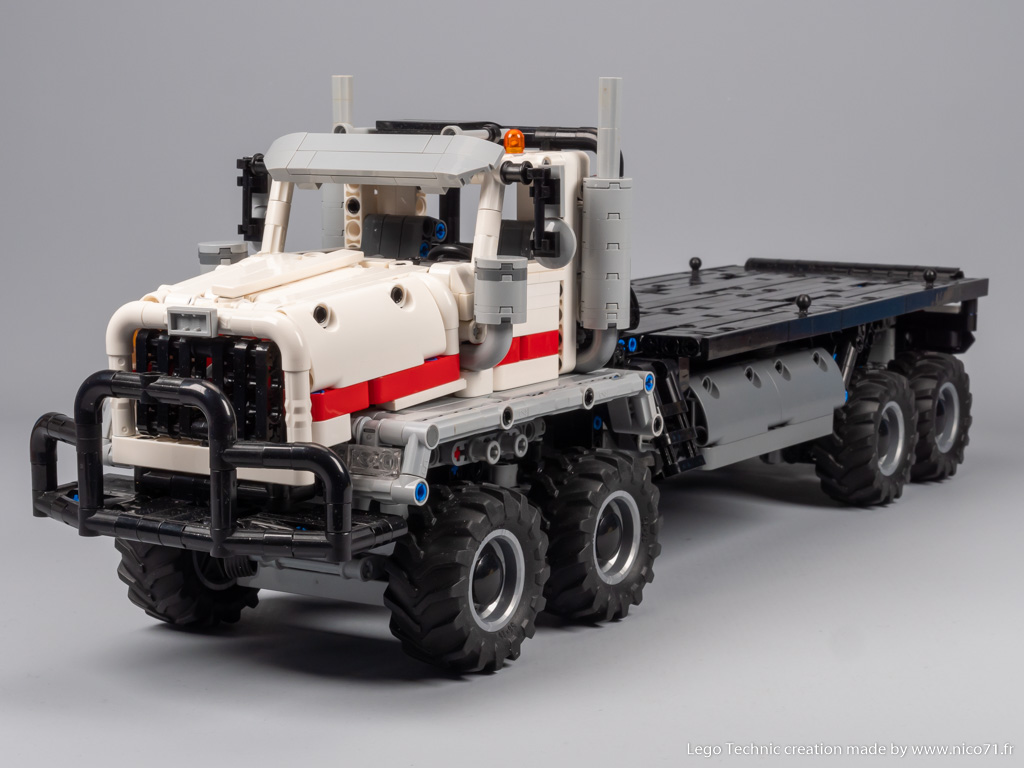

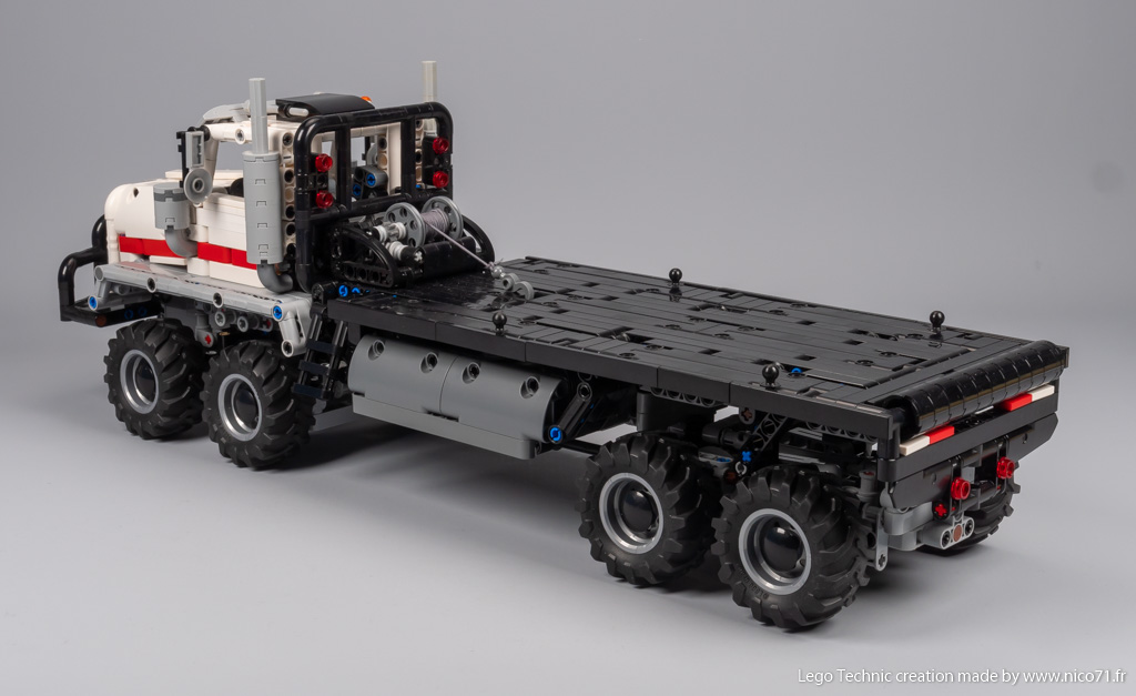

Here are some additional info about this Western Star 6900 TwinSteer :
The model :
lego-technic-ws-69-ts-2.jpg?i=2074994737
Specs
  • Western Star 6900 Twinsteer in Lego Technic : Scale 1/20
  • Dimensions : 48.5cm (L) x 12.6cm (W) x 17.5cm (H)
  • Weight : 1.4kg
  • 1551 parts (truck), 584 parts (Mudpump)
  • Remote controlled using Control+ Hub and PoweredUp App (Lego) (also compatible with Power Functions systems)
  • Drive : 2 L motor with 12/24, 12/20, 20/28 (differential), 8×4 no locking differential
  • Steering : L motor which drives both axle with different turning radius made using variable connecting rod
  • Winch : L motor with worm gearing
  • Suspensions : Tandem bogies with oscillating arms
  • Removal hood with fake working inline 6 diesel engine
  • Openable doors
  • Diesel Mud Pump in container style with optional motorization

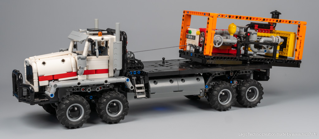

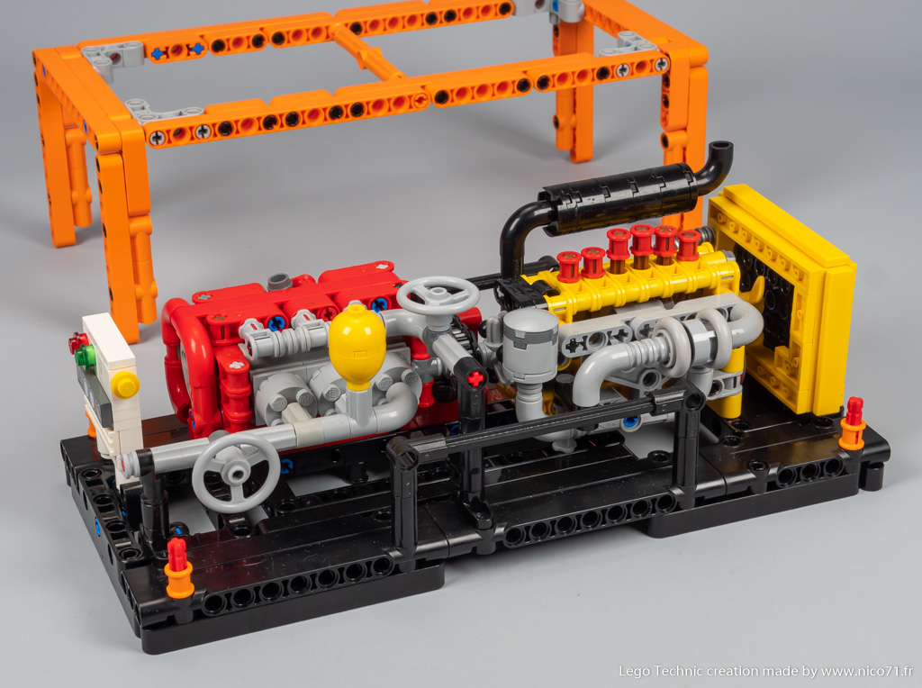

The load :
The load is a mud pump powered by a 6 inline diesel engine, in a container style. The orange frame can be removed, as well as an optional motorization can be added (see video at 2min for that [youtube]).
