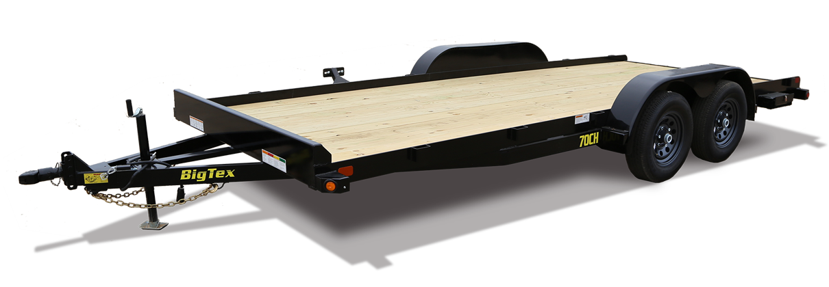

nico71 Posted May 22, 2023 Author Posted May 22, 2023 (edited) I have forgotten to post here my 1/8 Trailer : ------------------------------- A LEGO Technic tandem axle trailer to transport 1/8 cars (Bugatti 42083, Porsche 42056 or any other 1/8 Supercar). With storable ramps with locking mechanism, manual jack, adjustable towball height, openable and removable box. Available in three versions (5×7 frame, yellow frame, with wooden platform).(Ford F150 + Porsche GT3)Specs : LEGO Technic Replica of a Trailer BigRex 70Ch (Tandem Axle) Dimensions : 76.3cm x 36.6cm x 12.6cm (2.2kg) Dimensions of the car platform : With the box : 536mm (67stud) x 264mm (33stud) Without the box : 632mm (79stud) x 264mm (33stud) (the car can overcome the rear part as long as the rear wheel are supported) Two ramps with sliding axle to put in place (lenght : 27cm, approach angle of 8°) Ramps are stored underneath the chassis with locking mechanism Adjustable width of the Ramps Sturdy Chassis to support the weight of the car (symmetrical grid-built chassis to easily extend it) Adjustable height of the towball attachment point Manual jack with linear actuator and crank Openable and removable box (box inside size : 20cm x 7.2cm x 4.8cm) Adjustable wheel chocks Details : Lights, mudguards, chainss, guardrails, red/white stripping (Ford F150 + Porsche GT3)Inspiration model : BigTexTrailer 70Ch (Tandem Axle no Dovetail)Links :📲 More pictures, review, preview instructions [nico71.fr]🎥 Video presentation [youtube.com]❓ BigTex website [Bigtextrailer.com](Ford F150 + Porsche GT3 without additional box)Video (5x7 frame version presentation) : Edited May 22, 2023 by nico71 Quote

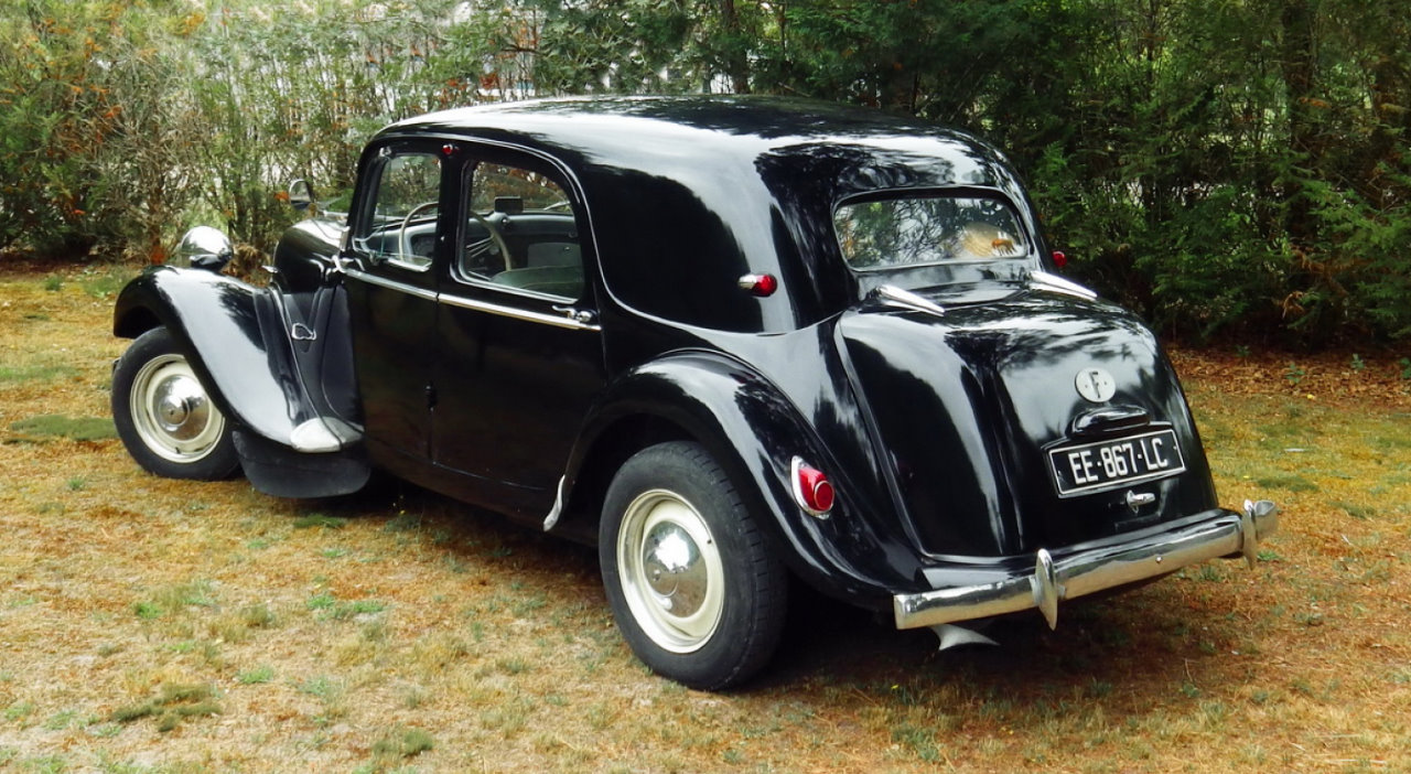

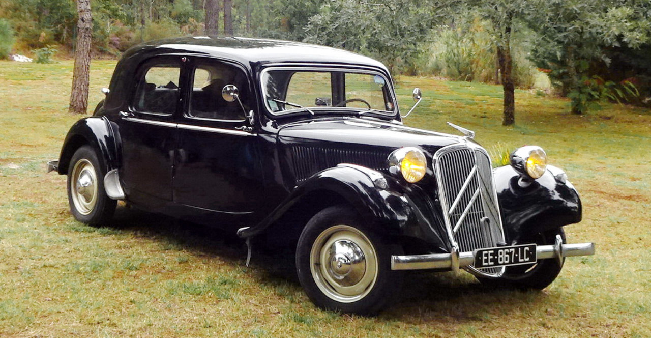

nico71 Posted May 29, 2023 Author Posted May 29, 2023 (edited) Following months of work to reproduce this beautiful French car, with its particular features at this scale and the iconic shape. TLTD :It is built at 1/15 scale (same scale as my 2CV, Mehari, 205 GTI), with working steering wheel and optional Hand Of God, green 4-cylinder engine with moving pistons connected to the front wheels (obviously), openable 4 doors, trunk and double paneled hood. The LEGO Model :LEGO Technic 1/15 replica of the Citroën Traction, with working steering wheel and optional Hand Of God, green 4-cylinder engine with moving pistons connected to the front wheels, openable doors, trunk and hood, with detailed interior and beautiful iconic shape reproduced in original black color.Original Model :The Citroën Traction Avant is the world’s first unibody front-wheel-drive car. Designed by André Lefèbvre and Flaminio Bertoni in 1933 / 1934, it was produced by the French manufacturer Citroën from 1934 to 1957 with approximately 760,000 units produced.Whilst front-wheel drive and four-wheel independent suspension had been established in the mass market by Auto Union and subsequently others some years before, the Traction Avant pioneered integrating these into a mass-production, crash resistant, unitary, monocoque body. [wikipedia](images courtesy of POA)Specs (LEGO Version) : Citroën Traction at 1/15 scale (same as my 2CV, Mehari, 205 GTI) Dimensions : 33cm (L) x 13cm (W) x 12cm (H), Wheels : Ø49mm, Weight : 630gr Based on Traction 11B model from 1955 with curved trunk Steering with lever / rod mechanism and working steering wheel Optional Hand Of God Front Wheel Drive without differential (not enough place at this scale) Green 4-cylinder engine with moving pistons and working fan Torsion bar independent rear suspension (can be lock with adding a pin) Openable elements : 4 doors, trunk and double paneled hood (can be removed) A great attention has been taken to reproduce the particular shape of the original model, with a special treatment on the surfaces finish as well as the colors or certain colored element (pin, axle etc).Links :📲 More pictures, review, preview instructions [nico71.fr]🎁 Complete package including Parts + Instructions at [buildamoc.com]🎥 Video presentation [youtube.com]❓ A great history page on [Traction-Owner-co.uk]Video : Let me know what do you think ! I am working on a design secrets video on that one, expecting to publish in some weeks as there is a lot to talk about the design. Edited May 29, 2023 by nico71 Add embeded video Quote

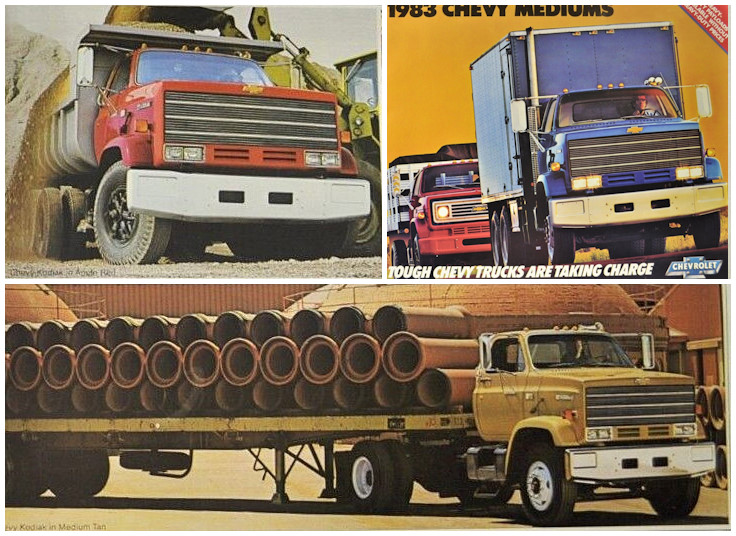

nico71 Posted August 14, 2023 Author Posted August 14, 2023 My new creation : Chevrolet Kodiak C70 Snowrunner’s Fan here ? Here is a replica of the Chevrolet Kodiak C70 in LEGO Technic, with 4×4 drivetrain, suspensions on both axles, working rear saddle, openable doors and hood, with removable V8 Diesel Engine, and removable cabin. With building instructions for two versions (Control+ or PFS).Original Model :In 1981, General Motors introduced the Chevrolet Kodiak and GMC TopKick as a variant of the medium-duty C/K trucks. A Class 7 truck, the Kodiak was developed to use the Caterpillar 3208 V8 diesel and was offered with both single and tandem-axle drive configurations; both straight truck and semitractor configurations were produced. The Kodiak / TopKick were commonly used in 80's as a basis for work trucks, cargo haulers, dump trucks, and similar vehicles which required medium duty torque. It is also a very good starter truck for Snowrunner's Fan, that I am, which motivated me to reproduce it in LEGO Technic.Specs (Control + LEGO Version) : Dimensions : 44 x 17 x 17cm, Scale : 1/17, Wheels : Ø62.4mm, Weight : 1.35kg 4×4 Drivetrain with Geared Hub and Differential (no lock) Dual wheel at the back, with 57360 Hinge Cylinder for the transmission in the geared hub Onboard Servo Motor steering with rack and pinion Fifth wheel (saddle) with locking mechanism for classic trailer attachment Fully suspended axle with links, springs and Panhard Rod Openable doors to reveal the detailed interior Openable left side box Openable hood revealing the removable CAT V8 Diesel Engine (connected to the drivetrain) Removable cabin, enabling to re-use the Class 7 Platform for other truck in same class (like GMC TopKick) Available in two versions : Control+ Motor (Poweredup App) or classic Power Function System (IR remote) Some pictures to display the features : 📕 More pictures, preview and bundle discount can be found on my website [nico71.fr] (-15% for 2 instructions, -20% for 3 on the whole cart)The Instructions : Instructions are step by step high resolution computer generated instructions (300DPI, 190 pages) with partlists, flexible parts, highlighted parts for each step with white edge on dark parts for better readability. A PDF tutorial of 19 pages is included to set up the command profile on the PoweredUp App from LEGO for the Control+ Version (ensure your smartphone is compatible prior purchasing) Example : See it in action : It is the first truck I did with the geared hub and the double wheel at the back so I have to inovate for the transmission by using the hinge cylinder over a dismantle U-join or an 16t gear. Plus the removable cab with segmented hood/mudguard which was not easy but I am proud of the result. Let me know your comment or questions ! 😀 Quote

Thirdwigg Posted August 18, 2023 Posted August 18, 2023 Another great build @nico71. I would see these TopKicks all the time growing up. Most were box trucks, and many were simple work and farm trucks. Thanks for bring me back to that happy spot. Quote
