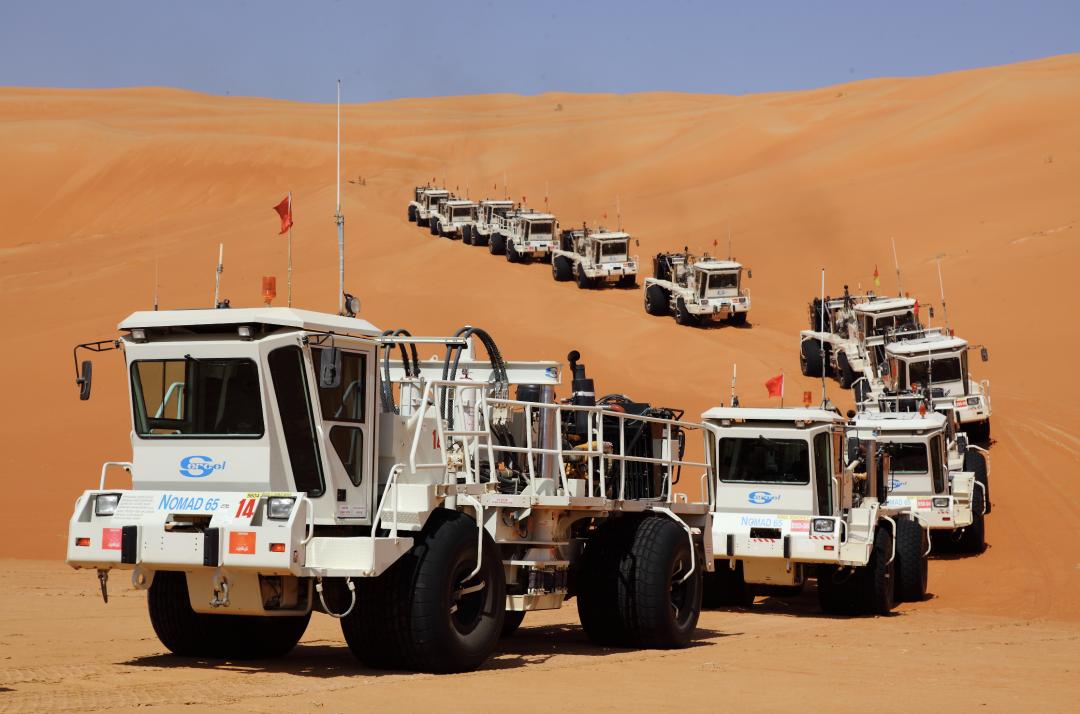

nico71 Posted June 17, 2024 Author Posted June 17, 2024 New creation !The Sercel Nomad 65, a vibroseis truck, recreated in LEGO Technic at 1/16 scale. Features 3290 parts, 68cm long, for 5 motorized functions : drive, steering, vibrator height, vibration module and winch, with working fake engine and openable elements.Demonstration Specs : Dimensions : L65 x W21 x H24 cm, Scale : 1/16, Wheels : Ø107mm, Weight : 3kg Drive : 2x XL motor with friction clutches and differentials Steering : 1L motor with two small linear actuators (internal clutches) Vibrator Height : 1L motor with two linear actuators (internal clutches) Vibration Module : 1L motor, geared up on eccentric mass Winch : 1L motor, worm screw on clutch gear (5mm/s) Fake Engine : CAT C13 working L6 Engine with details and fan Openable Elements : doors, front hub cover (rear accessible from underneath) Real pictures display the prototype model, where some color has been changed on the rendered version. The instructions and bill of material portrayed the rendered version (white cylinder in front of the vibrator module) Original Model :This vehicle is used in oil and gas exploration, by making the ground vibrated with a large vibrator. The vibrations propagated in the ground, bounce off the internal elements and are picked up in return by sensors on the ground in order to create a 3D map of the underground resource. These truck are often use in fleet with other oilfield support trucks.This project started as a commissioned project for Sercel in 2020, and was produced in 5 quantities for displaying in their showroom and being used in exhibition / training. In 2024, after some demands, I have created the PDF building instructions that I propose here which were one of the biggest ever done !Links :📲 More pictures, review, preview instructions [nico71.fr]🎥 Video presentation [youtube.com, 4min]🔰 If you want to add stickers on the model, you can download and print this file (A4, 100% zoom), or contact Forwart Sticker to buy the professional sheet.🧩 About 35% of the inventory is shared with the 42100 LEGO Technic set, which is a good donor set to build it (white parts, gear and grey connector, electronics), and explains why some pins are red (originally from in the 42100).📕 Bundle discount can be found on my website (-15% for 2 instructions, -20% for 3 on the whole cart).LEGO Technic Sercel Truck in the Sercel's Showroom at Carquefou (44), France Quote
bruh Posted June 17, 2024 Posted June 17, 2024 Yo! This is crazy cool! Already checked it out on rebrickable too! I seriously wish that I had the needed parts and had enough money to spend on this MOC. I would buy this, and I do support people who create premium MOCs, as long as they are good enough. If I had a full time job and had more money, I would buy more, but as of right now, I am a TFOL limited to my own creativity and free MOCs. Quote
nico71 Posted June 18, 2024 Author Posted June 18, 2024 Thanks for your comment ! No problem at all that you can afford the model, posting here is already a great value for me :) Quote
msk6003 Posted June 18, 2024 Posted June 18, 2024 (edited) On 6/17/2024 at 10:10 PM, nico71 said: Looks like tumbler tire will perfect for this vehicle. Is there a reason of use class tire? Edited June 18, 2024 by msk6003 Quote
nico71 Posted June 22, 2024 Author Posted June 22, 2024 It fact the Tumbler tire is too small (81mm), which will be more suitable for my wheeled version of the 42100 model B - Vibroseis truck, which is about 1/18 scale (lenght of 56cm for original lenght of 140m on the Truck) Here is 1/16 scale, so the tire is 107mm in tractor style (lenght of 65cm for 10m truck in real). I could use the 94.3x38r tire but the pattern did not match quite well, more truck style than offroad vehicle. So the LEGO model was based on off-sand version, with muddy tires (tractor style, which is a bit too narrow as well) : Quote

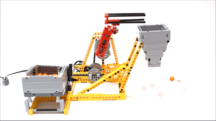

nico71 Posted July 26, 2024 Author Posted July 26, 2024 New instructions for an old creation (Free Instructions) : The model :A Great Contraption Module based on the Cardan Gear invented by Girolamo Cardano, from a simplified LEGO version of Torbjörn Söderstedt, build in 2015 for an exhibition. Here is a revised version with PDF instructions, with the helps of Daniel Garcia Argüelles (Daniel58).Quick Functions Showcase :How it works :A M motor operates two different mechanisms with crank / connector rod on sliding mechanisms : the Cardan Lift and the Input Tray. The Cardan Lift mechanism is composed of two arms, a first which is operated by the sliding mechanism, and a second which is attached to the chassis with a gear multiplication (40/20) using a differential to pass though the center. When the main arm rotates by 180°, the second arm makes 360° in the opposite direction. It enables the balls to be kept inside the fork and unload them in the output tray. A rubber band helps to prevent backlash in the functioning when the arm goes down.The second operated element is the Input Tray, which has an angled floor and a moving step at the end which can take only 6 balls. They are lifted when the Cardan Lift comes, and then, the step goes down and 6 other balls are loaded. 📕 Free instructions : https://www.nico71.fr/product/cardan-lift/ 🧩 Bill Of material : https://rebrickable.com/mocs/MOC-190380/Nico71/cardan-lift-great-ball-contraption/#parts 📐 Dimensions : 34cm (L) x 26cm (W) x 23cm (H), 1 M motor or crank operated Video : In action at Diemoz 2015 : Quote

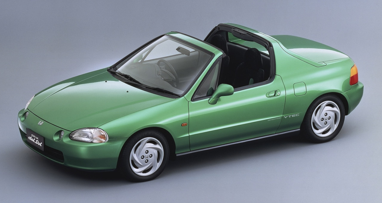

nico71 Posted November 13, 2024 Author Posted November 13, 2024 (edited) New creation ! The model :A Honda CR-X del Sol at 1/12 scale, made as a commission gift for a particular. It features front wheel drive with removable fake engine, steering, rear suspensions, openable hood, doors and trunk with targa-top. Available in two versions in one purchase : JDM and USDM.Quick Functions Showcase :Specs : 1/12 Scale : 33 x 15 x 11cm, Ø49mm wheel Front wheel drive (un-motorized) without differential Detailed engine bay with removable 4-piston engine Steering with rack and pinion and return to the steering wheel (rubber band) Rear suspensions with dismantled 76138 parts Detachable Hand of God (can be stored into the trunk) Openable hood (underneath blue pusher) and doors Openable trunk, to access the removable roof (targa-top) Available in two versions : JDM/EUDM and USDM (facelift without frog light and modified bumper) : 📕 You can see more data, pictures and instructions previews on my website [nico71.fr] 🧩 Bill Of material [rebrickable.com] 👍 Social link [Instagram.com]Original Model History :The Honda CR-X del Sol is a two-seater targa-top car manufactured by Honda from 1992 until 1998. Despite the body resemblance to a mid-engine car design, the del Sol is based on the front-engined Honda Civic platform and was the successor to the Honda CR-X. Known for its small aux-light on the front face, 90's bio design, and motorized T-top in option, it competes against Toyota MR2 and Mazda Miata with gazoline 1.5 and 1.6 Vtec engine, from 102 to 160 hp. The USDM version has a slightly difference bumper, with the removal of the small headlight in 1996 and rear spoiler in option. [wikipedia] Video : Edited November 13, 2024 by nico71 correcting image size Quote
Krxlion Posted November 13, 2024 Posted November 13, 2024 What a beautiful creation, my brother own that car 4 years ago. It was so light and happy to drive. I immediately knew what car is this that you are showing us. It's a pity original car didn't feature rear-wheel drive, it would make a great entry-level drift car like MX-5. :D Keep up the good work Nico, thanks for sharing. Quote
nico71 Posted November 14, 2024 Author Posted November 14, 2024 (edited) 21 hours ago, Krxlion said: I immediately knew what car is this that you are showing us. It's a pity original car didn't feature rear-wheel drive, it would make a great entry-level drift car like MX-5. :D Thanks for that comment ! If you recognize it, so the LEGO shape is at least correct ! Yes a RWD would have been cool, to compete with MX5. Or even a mid-engine configuration like the MR2. But the idea I think was more to take a 5g civic and try something cool with not so many industrial costs. There was a time where having a convertible / targa car was mandatory in the product range. Edited November 14, 2024 by nico71 Quote
