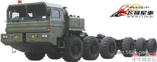

December 5, 201311 yr Anybody know any cool 12x12 trucks that haven't been build in technic as yet? Like this? :)

December 6, 201311 yr Anybody know any cool 12x12 trucks that haven't been build in technic as yet? Like this? :) One day when I have time and pieces I want to make a modular tatra-esque solution so you can have 6x6 or 8x8, 10x10 up to 12x12 by just adding steering or normal modules in pairs of wheels
