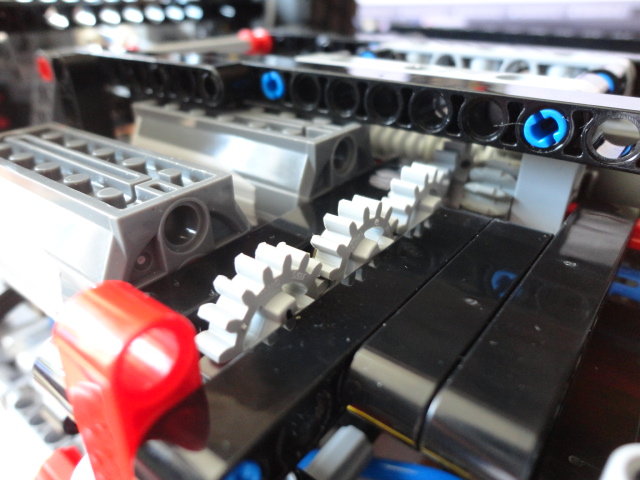

lukeandahalf Posted July 19, 2012 Posted July 19, 2012 (edited) @ lukeandahalf: Welcome to Eurobricks! VFracingteam posted this youtube of his motorized Lego 8110 Trial Truck: Thank you, I am glad to finally be a part of the community after "lurking" through the forum for so long! Has anyone had any experience with "ganging" two or three M motors together with 16t gears? I currently have two M motors powering my 8110, not quite enough power! I'm considering ripping the compressor and PTO gearbox apart and using the third M as well... Any thoughts? Edited July 19, 2012 by lukeandahalf Quote
Hopey Posted July 19, 2012 Posted July 19, 2012 Has anyone had any experience with "ganging" two or three M motors together with 16t gears? I have! Just finished it tonight. I need to get some better batteries before I can really say whether it worked or not. Quote
lukeandahalf Posted July 20, 2012 Posted July 20, 2012 Just finished it tonight. I need to get some better batteries before I can really say whether it worked or not. I am in the same boat with batteries. my solution so far has been to use three battery boxes for three M motors. I use axles to connect the battery boxes, and another axle though the holes on the switches of the boxes so all three can be turned on at once. It has much more torque with three M motors but still stalls on some hills. My next purchase will be two XL motors and IR reciever/remote. Currently steering is "leashed" with an old 9V battery box and motor. As an aside, I created a brickshelf account this afternoon, but when I try to view the images it says the haven't been made public yet? Curious. Quote
