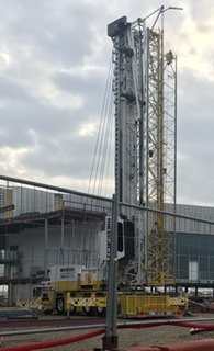

virgule972 Posted January 26, 2020 Posted January 26, 2020 Everyday I can see the real model at my work ? 41 minutes ago, efferman said: A small break for lunch. « Bon appétit » Quote

brickless_kiwi Posted January 29, 2020 Posted January 29, 2020 On 1/27/2020 at 12:41 AM, virgule972 said: Everyday I can see the real model at my work ? « Bon appétit » Not something I have seen before is the crane self propelled or towed and who makes them kind regards matt Quote
efferman Posted January 29, 2020 Author Posted January 29, 2020 (edited) The Rolling chassis is now complete. The Trailer axles are suspended. [ edit: Trailer for counterweights when Crane is upright. Edited January 29, 2020 by efferman Quote
Beck Posted January 30, 2020 Posted January 30, 2020 (edited) Great work @efferman! Having previously tried to build a self erecting tower crane, I can understand how difficult this project must have been. 16 hours ago, brickless_kiwi said: Not something I have seen before is the crane self propelled or towed and who makes them kind regards matt Pretty sure that's a liebherr mk140/110/100. The company appears to be mediaco from France. Edited January 30, 2020 by Beck Quote
Saberwing40k Posted January 30, 2020 Posted January 30, 2020 17 hours ago, brickless_kiwi said: Not something I have seen before is the crane self propelled or towed and who makes them kind regards matt This particular folding tower crane is self propelled, but there are towed versions. A number of companies do make them, including Liebherr and Spierings. Google Self Erecting Tower Crane, and that should give you more info. Quote
virgule972 Posted January 30, 2020 Posted January 30, 2020 (edited) A mediaco crane A very strange self-supporting crane, because the mast stands vertically. I will try to take photos when it is in operation. Edited January 30, 2020 by virgule972 Quote
