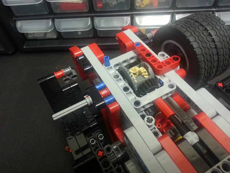

Posted January 2, 201213 yr I was going to write a quick review of 9395, but I see that TechnicBricks beat me too it. Instead then, I'll present a small improvement I've made. 9395 is quite a lovely tow truck, but it has one fatal flaw, and that's the lack of tandem wheels on the rear axle. As it turns out, converting it is quite simple and requires very few additional parts (apart from the wheels). Pictured below is the model as designed by LEGO. You can see the big spacers between the chassis frame and the wheels. Those will have to go. There is so much space there that it almost looks like they left it open intentionally. See the 3L light gray axle sticking out just to the right of the wheel on the lower part of the image? Those will have to go and get replaced with 2L so they don't protrude. The 3x5 liftarms will be rotated and a couple of pins will get moved. Finally, the axles coming from the differential will get replaced with 6L. When all is done, here is what you get: So much better! This truck is very like those I see every single day in the northwest of the USA, and never in life have I seen one without a tandem axle, so this makes it much more realistic. Enjoy!

January 3, 201213 yr Hi, I did nearly the same mod - but for the axles coming from the differential, I needed 8L for replacement - how did you manage to use 6L axles?

January 3, 201213 yr Author I did nearly the same mod - but for the axles coming from the differential, I needed 8L for replacement - how did you manage to use 6L axles? I did it by accidentally typing the number 6 instead of the number 8. You are right, they are 8L.

January 1, 201312 yr Replace the Pin Connector (48989 3L with 4 Pins) with two Long friction pins (6558). Use two half bush or one full bush in between the frame and the 1 x 3 black lift arm. On the otherside of the 1x3 lift arm use another half bush.
January 1, 201312 yr @ 750ACE: What would that do, to replace the 48989 "Light Bluish Gray Technic, Pin Connector Perpendicular 3L with 4 Pins" with two 6558 "Technic, Pin Long with Friction Ridges Lengthwise" parts? -->
January 1, 201312 yr @ 750ACE: What would that do, to replace the 48989 "Light Bluish Gray Technic, Pin Connector Perpendicular 3L with 4 Pins" with two 6558 "Technic, Pin Long with Friction Ridges Lengthwise" parts? --> Correct, then put a 1x3 black lift arm on the end. Add a full size bush in between and a half on the end. It's a quick hack fix but it works pretty good. How can I attach an image?
