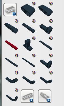

I read the whole thread and haven't found my problem. Has anyone else problems with the 9M Beam, which is only available in a strange looking red?
Laix are you in 'LDD' mode?If you chage to 'Extended Mode' you will be able to select different colors of the '9' liftarm.
Mine shows up as a dark red in 'LDD' mode.
Edited by Alasdair Ryan
Thanks for your help, I added the Extended Mode long time ago, but I wasn't aware that you can choose to work in a "downgraded" version after that. Now it works :thumbup:
