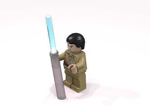

January 24, 201411 yr Sorry for the double post. I've made some tests for the light source and it seems to work. Thanks again ! I've had an other idea: would it be possible to add an incandescent aura around a transparent part. In fact, it would be to improve the lightsaber's blade effect. I've found this code on a POV-Ray Tuto (here), but I was not able to make it work: Reveal hidden contents pigment{ color Clear } or pigment{ color rgbf<1,1,1,1>} #declare Blade_Center = object{ Round_Cylinder(<0,0,0>,<0,1,0>, 0.02, 0.01, 1) pigment{ color rgbf<1,1,1,1>} // the container should be clear hollow interior{ media{ emission <1.0,0.1,0.5>*7 } // end media } // end interior } // end object //---------------------------------------- union{ light_source{<0, 0, 0> color rgb <0.5,0.0,0.3>*0.75 area_light <0, 0.1, 0> <0, 0.9, 0> // 1, 5 // } //--------------------------- object{ Blade_Center } //---------------------------------- object{ Blade_Aura } //---------------------------------- // + handle see scene description ! }// end of union ---------------------------
January 24, 201411 yr Hi Courleciel, please find here (http://bricksafe.com...charly/test.pov) a complete povray-file (3.7) which I set up especially for you. Basic scene: Scene with enlighted brick, inner aura and outer aura: Not sure, if this is the effect you wish to achieve. However, what you see is more or less the result of copying the scene file out of the POV-Ray Tuto and applying it to the basic scene above. Now it's up to you to tweak it to suit your needs. I would highly appreciate to see the results of your project here. …. and may the force be with you. regards papacharly

January 25, 201411 yr Thanks again for your help papacharly. I've tried to apply your code on my pov ray file. Ouah, that's not easy ! Here is the result (after many attempts): Reveal hidden contents But I still have some issues: - the aura's color - the light's reflection: is there a way to remove the reflection only for the enlightened parts ? - the coordinates. It seems they are of its type : x1,y1,z1,x2,y2xz2,x3,y3,z3,x4,y4,z4. But what are these points ? The center of the part, the point of contact, the extremity points ?... I've added this: Reveal hidden contents // Brick Light light_source {<-0.72383087873458862,2.9674797058105469,1.5550704002380371> color rgb <1,1,1>*50 } // outer aura #declare outer_aura = object{ Round_Cylinder(<-0.72383087873458862,2.9674797058105469,1.5550704002380371>,<-0.25881800055503845,-0.9512515664100647,0.16773106157779694>,0.3, 1, 1) pigment{ color rgbf<1,1,1,1>/2} hollow interior{ media{ emission <1.42,1.0,1.12> }}} union{ light_source{<-0.72383087873458862,2.9674797058105469,1.5550704002380371> color rgb <1.42,1.0,1.12>*0.75 area_light <0, 6, 0> <0, 28, 0> 1, 5 } object{ outer_aura } } And here is the line code of the concerned part: ldd_30374(array[1]{42},array[1]{0},array[1][12] {{0.96566987037658691,-0.25881797075271606,0.022248197346925735,0.022248188033699989,0.16773106157779694,0.98558169603347778, -0.25881800055503845,-0.9512515664100647,0.16773106157779694,-0.72383087873458862,2.9674797058105469,1.5550704002380371}}) Edited January 25, 201411 yr by Courleciel
January 25, 201411 yr Hi Courleciel, it seems that you are using LDD? I am not familiar with this. So regarding the coordinates I cant give a hint. Maybe somebody else can do? Regarding the auras color I have added some comments to the povray-file (http://bricksafe.com..._Lightsabre.pov): Have a look to the light sabre part at the end of the file. BTW: I suppressed the sabre part 30374. So the light sabre scene is: Could you please specify your “reflection-question” ? Je pédale dans la choucroute! Hope, its now easier for you to go ahead. … and never give up (reading some more povray tutorials ). regards papacharly

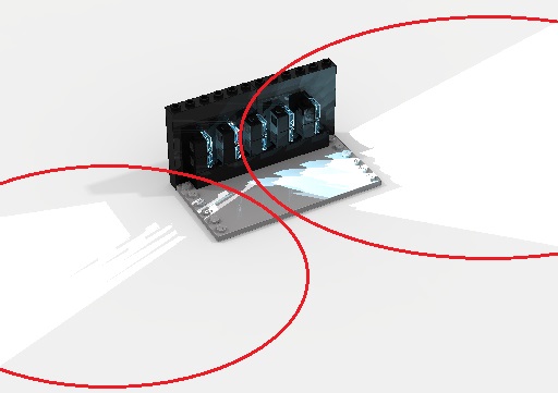

January 26, 201411 yr Hi, Thanks. Your scene is exactly what I'm trying to do ! Indeed, I'm using LDD. So it's still difficult to place the auras since the coordinates seem to be very different between the two softwares... Concerning the reflection. Well, I've created some light sources on many parts (which are very close), and it has given a big flash on the floor. Consequently, I was wondering if there is a simple way to remove this light reflection (only for the enlightened bricks, I would like to keep the reflection and the shadow for the other parts with no light source). Edited January 26, 201411 yr by Courleciel
January 26, 201411 yr You have to use "fade power" and "fade distance". Here is an example pov-file (http://bricksafe.com...harly/light.pov) showing how to use these functions. I added some comments to the light description at the end of this file. Any more questions?
January 27, 201411 yr Hi, Many thanks for your help. I'm really sorry, I do my best to understand how to resolve this problem... I've tried to illustrate my problem as you've done previously: Reveal hidden contents I've though it would remove these undesirable areas. In other ways, I would like to keep the light source inside the center of the parts. As you advised me, I've changed the fade_distance and the fade_power. Even though they are both equal to 0, it still gives reflections. Reveal hidden contents light_source { <-5.1999988555908203,1.8400000333786011,4.1600008010864258> color rgb <1,1,1>*5 fade_distance 0 fade_power 0 } I've also tried this: light_source { <-5.1999988555908203,1.8400000333786011,4.1600008010864258> color rgb <1,1,1>*5 spotlight point_at <-5.1999988555908203,1.8400000333786011,4.1600008010864258> fade_distance 0 fade_power 0 } But it seems it cancels the initial light_source effect. Edited January 27, 201411 yr by Courleciel
January 27, 201411 yr Setting fade power = 0 is not the best choice. You have to understand fade power as a "damping factor". So the higher fade power is, the less bright the light gets. So go for fade power = 5 or 10 and see what is happening. Fade distance = distance of full light intensity: So only light which is travelling further than "fade distance" is getting damped. As the length of a brick 1x1 is 20 (for Ldraw parts), so fade distance should be > 10. Otherwise it might happen that the light wont emerge out of the brick at all. If you cant resolve the problem so feel free to send me your complete pov-file and I will try to fix the problem.
