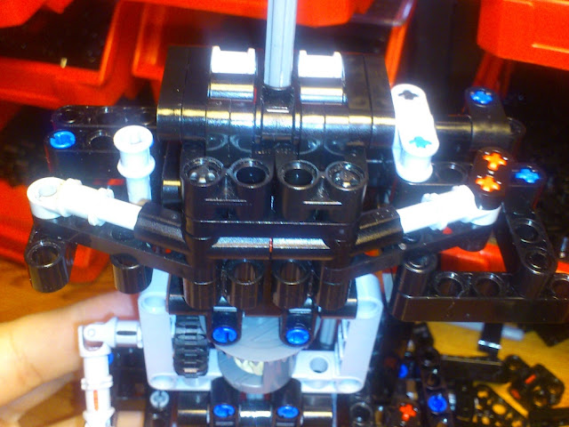

Here is the first axle of the new MPS season ;)
MPS. Rear axle IV: Live axle with leaf spring
Following the idea by legomuppet9.
With drive (code F.CD)
- R.CD.2
This leaf springs uses angle connectors to "looks like a eliptic" leaf spring, and also the connectos and the 3L axles give a great elastic force.
It works really well, is very strong and uses very common parts

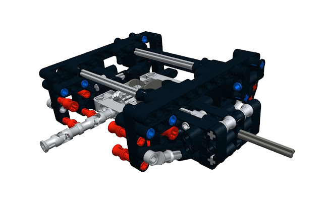

One more MPS rear axle
MPS. Rear axle V: Torsion-beam
Following idea by Zachary Cross
Without drive (code: R.D)
- R.D.1
As always you can download all axles and chassis in only one link: Download
