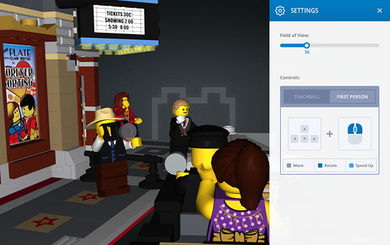

I added a Setting Panel to the model viewing module (used on mecabricks itself as well as external websites such as brickset or bricker).
Click on the top right button on the main window to make it appear.
You can then change the Field of View (FOV) using the slider and switch between 2 control modes - Trackball (default mode as before) and the new First Person. This last mode is pretty cool to visit the inside of the big buildings.
You can use the arrow keys to move forward, backward, left and right (works with Z, S, Q, D or W, S, A, D ). to go up and down use the keys P and L.
Try with the Parisian Restaurant for example. I generally increase the FOV to about 50 to get a better experience with the First Person mode.

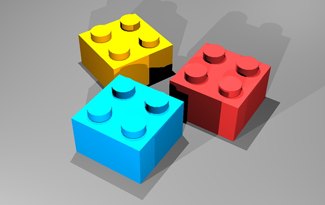

I started to work on the 3rd version of the workshop - recoded from a fresh start - however I've been side tracked when I've seen that Threejs (the 3D framework that I use) is trialling a ray tracing renderer. I briefly played with it today and here is a picture that I generated from a scene built with mecabricks. It is not perfect, but very promissing. Maybe in a close future when this renderer is more advanced, I'll include it in the production version of mecabricks to render more realistic pictures of the 3D models.
