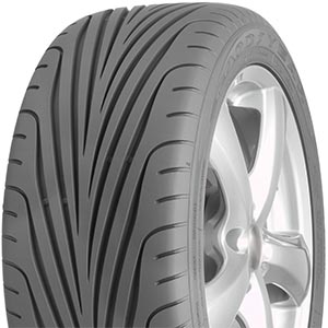

What I'd like know is some mid/low profile RC tires with tread patterns like Goodyear Eagle F1 or Dunlop Direzza Sport Z1
Some that fit 44772 LEGO wheels, but even better if we can find some for the larger 22969 wheels. :sweet:
Problem is that websites selling RC spare parts, don't use to provide detailed info about wheel profile and dimensions the fit the tires. So one has to have them in hands to check if the fit. :sad:
