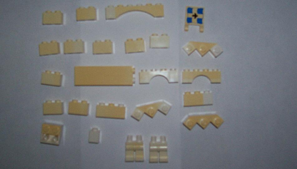

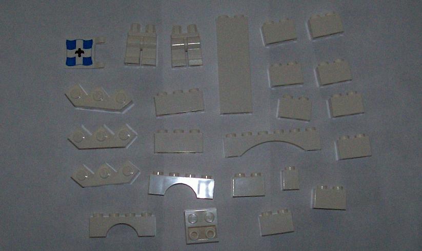

So here are my results. Pics are a bit blurry but you can clearly see the extent of the yellowization on the bricks and how immaculate they came out. I did a solution of 2 teaspoons oxyclean and the rest regular 3% peroxide in a lidded glass jar and put out in the sun for about 6 hours. I did another few bricks today using just 3% peroxide and got even better results on some colored bricks. So I'm not entirely sure the oxyclean is even needed. Also Nothing cracked or got damaged in the slightest and grip power was certainly not affected.
Before:
After:

WOW! I never had any pieces that yellowed (although they were pretty bad). That's some incredible results, although my experience differed from yours... before I heard about using Oxyclean, I just used hydrogen peroxide and had to leave the bricks out for four or five days. With oxyclean, less than one day's worth of sunlight (maybe 9:00am to 5:00pm) is enough to make them clean.

That looks fantastic. I especially like how it seems to have picked out the yellowed surfaces only. Pieces that are yellowed due to UV exposure (as opposed to oxygen exposure) tend not to be so uniformly across the whole piece.
Do the pieces still look exactly the right color though? I had previously heard that these techniques don't work well for old gray and the pieces end up in a color closer to bluish gray.
