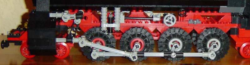

Ultimately I plan on putting these under a new 4-8-4, but for now I borrowed by Milwaukee Road S3 to try the rods out,
here is a shot of the previous drivers next to the new drivers
This locomotive design uses 9v motors for the pilot and trailing trucks and the drivers are simply dragged along behind the front motor. As such, the cylinders have to be fairly wide to clear the motor on curves and you do not have much space to actually build the cylinders (I did not think to get a detail shot of the cylinders, but I will try to do so soon). In the end it came out to be just under 11 wide. I tried to take an unflattering photo of the build, but aside from blurry shots, I couldn't find an angle where I thought the valve gear protruded too much (see examples in the folder once moderated)
I would caution that it is hard enough to make a steam locomotive run well with just side rods and connecting rods. So I would recommend that you do not wander too deeply into the valve gear until you are comfortable building and adjusting technic constructions.
The running gear in v4 might look simple enough, but it was actually a fairly complex build. As noted in an earlier post, I cut down a pair of 3x3 technic half beams to 2x2 to anchor the eccentric behind a blind driver (you could probably keep it unmodified behind a flanged driver). I also cut down a technic axle pin with towball to connect to the eccentric (inspired by LT12V). Using the 3mm thick valve gear bars, the bar connecting to the eccentric and the rocker bar have the cuff turned to the inside of the locomotive- to keep the pin heads from knocking against the side rod. Then the final bar had the cuff turned away from the locomotive to facilitate connecting to a black 2 long technic beam behind it. The end point of the valve gear and the side rod differed too much to use the 2 long valve gear bar to connect the valve gear to the piston as I did in v2.
The valve gear look great at slow speeds (click here for a short movie) and I've run the locomotive for a few hours without any trouble. Since PF does much better than 9v at slow speeds, I suspect PF is where the valve gear will really shine.

I should hang my head in shame Benn because everytime I see your lovely Milwaukee Road S3 I can't help thinking of it as being the 'piano locomotive'.
Marvellous to see the video of the new valve gear in action. Now I find myself trying to choose an NZR tank locomotive with outside valve gear that I would like to build. One of the larger classes, but not so large it wouldn't be seen on a sleepy little twiglet of a branchline..

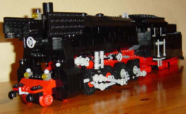

Some years ago I was asked by my son to try to build a german type steamm engine, tried to do my best but unfortunately did not have proper wheels so tat's what came outpost-33219-0-50858500-1353775330_thumb.jpgpost-33219-0-39750000-1353775331_thumb.jpg
Heh heh. At first I was wondering what the heck you were talking about, but yes, from the side view the running board really does look like a piano keyboard, doesn't it. As soon as you get some elevation you see through them and it looks more like the grillwork I had intended. I wanted to get the band of silver there and keep the running boards "light". Her sister, my A3 (the middle locomotive in this shot) is worse, but the checkered flags gave me the thin white stripe necessary for the profile shot. Ah compromises.
Wow, that is a very nice locomotive. Given the fact that you used mostly basic brick and plates it is fantastic (none of this cheese slope cheating the laws of physics stuff). I'm guessing you built it around 2000 or earlier. It looks comparable to the cutting edge designs prior to BBB wheels (excluding the occasional steamer that had machined driver wheels). I think Dan Siskind had similar driver wheels on one of his designs of that era. My first engine from about that time was an 8 wide diesel switcher with rubber tires and similar basic brick design- although it might be a little clunky, it has nice detailing given the resolution and I still proudly display it on a shelf in my office.
