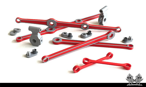

galacticslave Posted May 28, 2013 Posted May 28, 2013 Would it be possible to use these rods to fit a 7760 engine and what wheels would you use? It doesn't have to be powered. Quote
zephyr1934 Posted May 29, 2013 Author Posted May 29, 2013 Would it be possible to use these rods to fit a 7760 engine and what wheels would you use? It doesn't have to be powered. Probably yes if you don't mind a compromise. I don't have any of the 12v wheels or the 12v rods so I couldn't replicate the connection (and as mentioned earlier in this thread, I do not have the resolution to fabricate pins). The quick and easy solution would be to use the modern PF train wheels, 55423, or BBB small wheels then use something like this across the center axles, You could probably use this to also hold the center wheel in place if you did not have a 12 motor. Of course that approach does not have the the rod actually moving with the wheels. I could also do my "thin" design, shown here in white, if the standard rods are too "heavy" looking. If you wanted the rods to move with the wheels and you don't mind modifying your lego, I'd suggest using a technic axle and this lift arm, as a guide to drill a pin hole from the back side of the 66423 wheels. Or if you want to keep it pure, you could use but your locomotive would be wider and I've found that the axle holder on these parts do not have much clutch compared to other technic connectors. Quote

Wolfcraft Posted April 26, 2014 Posted April 26, 2014 These are great! Just two things. First, They look a bit rough in the pictures. Are they supposed to look like that? And Secondly, how exactly do you make them? Quote
zephyr1934 Posted April 26, 2014 Author Posted April 26, 2014 These are great! Just two things. First, They look a bit rough in the pictures. Are they supposed to look like that? And Secondly, how exactly do you make them? Hi Wolfcraft, welcome to Eurobricks and thanks for the kind words. Yes, they have a matte surface and they are a little grainy. If you look close at them you will definitely not mistake them for lego. However, they do a good job blending in, so often you will not notice the slightly rough surface. I personally think it is more pronounced in the photos because many of the shots in my brickshelf pages are larger than life (and I'm not a great photo editor, but don't tell anyone, okay?). The nice thing about this rapid prototyping is that there is very little setup cost for the first item. So it is well suited for special requests. I have fabricated over 60 different part designs for the rods and bars, many only once or twice for special orders (want a half stud offset, asymmetrical rod? No problem). Everyone is going to want a slightly different spacing. Another nice feature with the rods is the fact that I can go much longer than the standard 7 long half thick technic beam. The down side about this rapid prototyping is that there are very few economies of scale. I am able to absorb the setup costs by fabricating many parts at a time, but that only goes so far and the prices are high because that is what I need to charge. However, at this price, I definitely want you to be happy. So use your judgement. Oh, and note that my store only lists the most common parts. If you want something else, just send a message either via EB or BL messages and we see what is feasible. Quote
