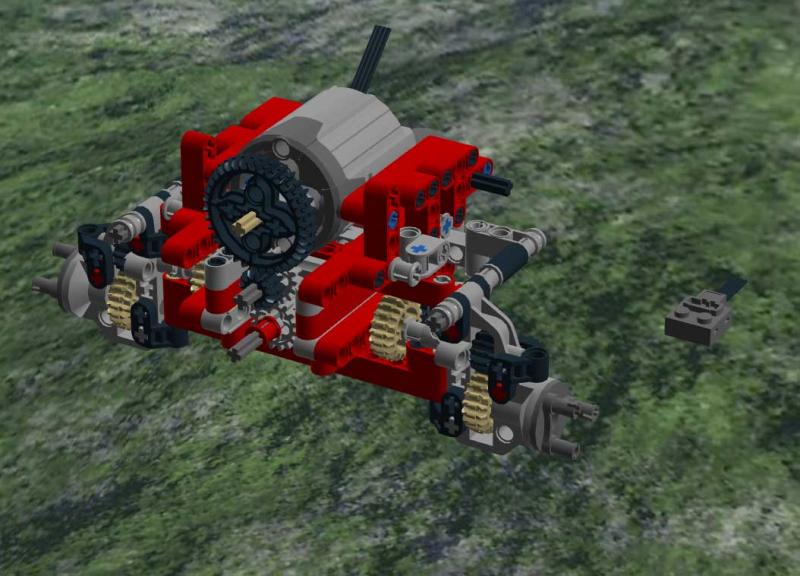

SuperCAD Posted September 9, 2013 Posted September 9, 2013 First attempt at adding an XL to the 41999. I'm sure something will have to be done with the shocks due to the increase in height, but this should get it started. Here's the file from LDD if anyone wants to mess with it. 41999.lxf Quote
legomuppet9 Posted September 9, 2013 Posted September 9, 2013 You can't attach the shocks in the normal place with that setup... Quote
