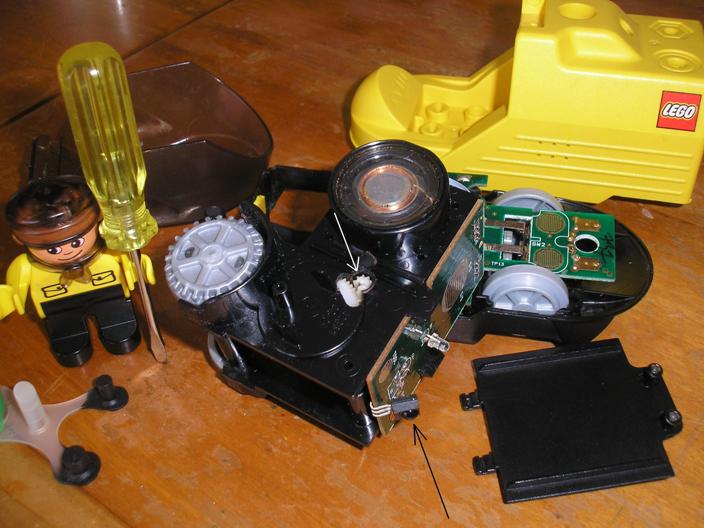

ShaunC Posted June 12, 2016 Posted June 12, 2016 Hi everyone, Mike: you didn't buy that train off ebay in Australia by any chance? I recall seeing an item for sale that matched your description. As it happens, I have an open (non-working) intelli-train somewhere on my workbench at the moment. The problem with mine is a stripped gearbox, so the circuit board may still be OK. If you like I could take a photo of the circuit board for reference. I have an intelli-train from a 3325 set, also with a broken gearbox. Does anybody know if this is repairable? It is the primary gear on the motor shaft which has cracked and parted company with the shaft. White arrow on the photo. I was going to ask what the infra red sensor was for (black arrow), but I see the answer is already on this thread. Quote
Peter Nolan Posted June 12, 2016 Posted June 12, 2016 Yes, you can buy replacement pinions. I did this for a couple of trains using plastic replacements. Looking on ebay it seems that only brass ones are available at the moment.You could try http://www.ebay.com/itm/Pinion-gear-Replacement-Gear-for-Lego-Duplo-Intelli-Locomotive-Module-0-4-9-/201444974931?var=&hash=item2ee70e6153:m:mYQEmFvY5iw4Oeq_D7I26Cg (no affiliation with me). As for how to actually get the pinion off, you could try looking at: http://www.papa-mach-ganz.de/pdf/PapaMachGanz-LEGO-Duplo-Intelli-Lok-Zahnrad-wechseln.pdf. It is in german, but the pictures are useful. Good luck! Quote

foreman_builder Posted October 17, 2016 Posted October 17, 2016 Hi all, I'd like to bother you a reoccuring problem: the stop sensor. I just cannot find the proper answer in this forum. My problem is the same as many other's: Train starts but stops after 1 second. I removed the reed relay and connected the wires. No changes: starts but stops in 1 second. The train is in excellent mechanical condition from the inside. Thanks in advance. Adam Quote
ballzack Posted April 4, 2017 Posted April 4, 2017 Hey adam, I just happen to have the same problem with the trains...changed the battery's and they don't stop immediatly. Looks like there is a fail safe for smaller kids: the train stops when it doesn't feel traction. So when our kids lift the train, they can't hurt thein small fingers. About some track layouts: I have 3 kids(8, 5 and 2.5year old). I try to build one long track and use 6 switches to divide it in 3parts where in my kids can sit/stand. Each one is responsible for his own piece of track and they need to work together to get the train around the long track... Quote
