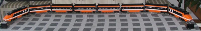

The most critical part of this layout are the two identical inclination sections - Ramp Alpha and Ramp Beta - between level 0 and level +1. Total length approx. 20 meters each, total climbing altitude approx. 120 cm. Since all 180 degree curves will be on plane levels - for safety reasons - the inclination is approx. 8 percent.
The total weight of the extended Horizon Express is approx. 3 kg that have to be pulled "all the way up to the top". I calculate to have two 9V transformers in synch for each Ramp section with 2x4 connection points - every 5 meters - basically side by side. So my key question: Will the two transformers manage to get this train - with 4 engines and a total weight of 3 kg - all the way up to level +1? Will 4 x 300mA be enough or do I need to consider even more engines (and eventually more trafos) for such a heavy train given the size and length of these inclinations?
Experience from my previous layout (Brickshelf, DaRePo) with similar inclinations (approx. 8 percent) but shorter track length showed that there was no problem getting a 4 engine powered full sized Santa Fe train "all the way up to the hill" (ground level + 35 centimeters), with two 9V transformers in synch and no multiple connections at all (total track length for that loop - up and down - approx. 10 meters).

This is how this trainset looks like
The most critical part of this layout are the two identical inclination sections - Ramp Alpha and Ramp Beta - between level 0 and level +1. Total length approx. 20 meters each, total climbing altitude approx. 120 cm. Since all 180 degree curves are on plane levels - for safety reasons - the inclination is approx. 8 percent.
