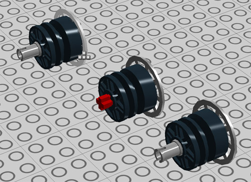

It's not possible to attach a #62701 HUB CAP d 24 to a #55928 RIM WIDE 18x14 W. CROSS d 4.8 without an helper (a cross axle) as could be done in the real world, for example when using the #6562 CONNECTOR PEG/CROSS AXLE
Do you know if it connects without a helper in any official sets? (i.e. could the connection between the rim and the hub be considered a LEGO connection). If yes, then LDD should support it.
It seem they only do it for scenic reasons (for example: http://www.brickset....ail/?set=8184-1 ), but this rim + round plate doesn't work too, and it's in 10220 VolksWagen Camper, so I bet it's the same problem as the rim cap and the 1x1 round plate (the largest ring) have the same diameter

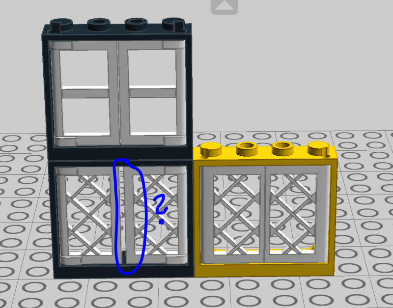

60607 (lattice 1/2 for frame 1x4x3) does not connect with its respective frame 6556. I'm actually trying to place the part on a pair of 3794 (a real set procedure), but haven't been able to get that to work. I tried to use the trick mentioned on another thread, but since I can't get the lattice in the piece it is designed to work with, I'm kinda stuck. :sceptic:
Door 60607 and 60608 will connect to frame 60594 (left in image).
Door 2529 will connect to frame 6556
Does that answer the question?
But what I do find strange is that the 60607 doors have a wider gap between them then 60608. Is it really supposed to be like that?
BTW: where did you find the use with the 3794. Now you got me curios.
