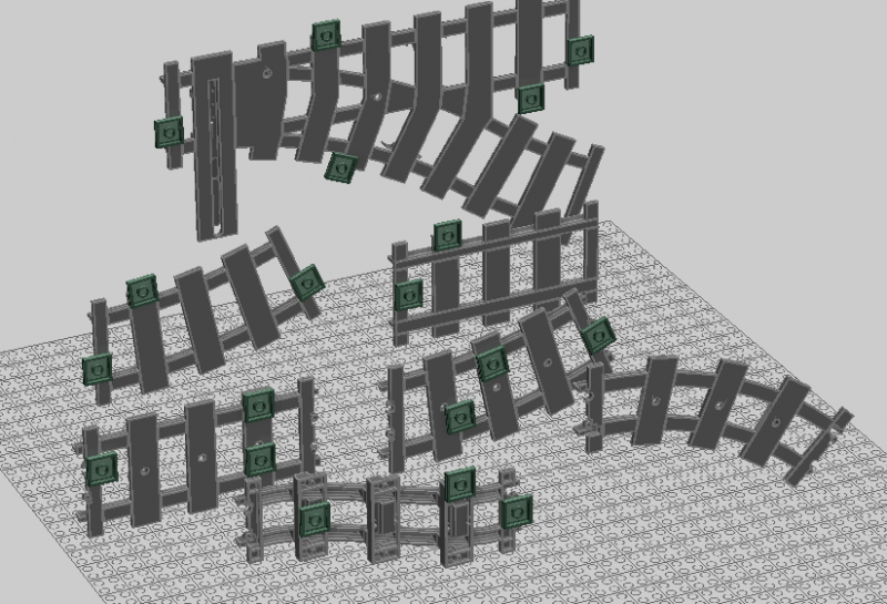

Banjo Posted April 12, 2013 Posted April 12, 2013 (returning to LDD after a long absence!) Is the railway track bug not fixed? I remember several people mentioning it a few versions ago, but I updated to LDD 4.3.6 today and noticed that I still can't get pieces to join to the underside of railway tracks (part #85976, for example). To see this technique in "real" action, Alien Conquest set 7065 is a great example, so it should be possible in LDD, right? Quote
Superkalle Posted April 12, 2013 Author Posted April 12, 2013 (returning to LDD after a long absence!) Is the railway track bug not fixed? I remember several people mentioning it a few versions ago, but I updated to LDD 4.3.6 today and noticed that I still can't get pieces to join to the underside of railway tracks (part #85976, for example). To see this technique in "real" action, Alien Conquest set 7065 is a great example, so it should be possible in LDD, right? I didn't note myself that it wasn't fixed. And yes, it should be possible in LDD. Quote
Banjo Posted April 12, 2013 Posted April 12, 2013 I didn't note myself that it wasn't fixed. And yes, it should be possible in LDD. After more testing today, I can confirm this bug still exists. Hopefully it will be fixed next update! Quote

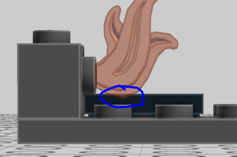

Banjo Posted April 13, 2013 Posted April 13, 2013 (edited) Just encountered another "can't do it in LDD but can do it in reality" bug, while trying to make Heroica's "Fortaan" set (3860). When making the fireplace in the castle kitchen piece, you are supposed to be able to place 87087 (brick 1x1 w/knob) beside 2412 (radiator grille), with the right-angle knob/hole facing the grate, then insert 64647 (feather) into the knob/hole to simulate the "fire" over the grate. This works fine physically, for real, but in LDD you cannot insert the feather ("fire") into the knob because it collides with the grate next to it, even though it *should* be just low enough to the to allow this. Hopefully the attached images from the Fortaan instructions make this tricky-to-explain issue clearer. I've also attached an lxf of the piece fully constructed, but with 64647 "angled" to fit the hole. Play with it and you'll see with the "fire" pointing straight up (as it is in the instructions and real model), it refuses to insert, due to the proximity of the grate below. I'm not sure if this can be fixed, but hopefully it can! EDIT: images and lxf deleted due to forum attachment limitation. Edited April 14, 2013 by Banjo Quote
Superkalle Posted April 13, 2013 Author Posted April 13, 2013 (returning to LDD after a long absence!) Is the railway track bug not fixed? I remember several people mentioning it a few versions ago, but I updated to LDD 4.3.6 today and noticed that I still can't get pieces to join to the underside of railway tracks (part #85976, for example). To see this technique in "real" action, Alien Conquest set 7065 is a great example, so it should be possible in LDD, right? I had a look at this today again with 85976, and it does actually work to connect to the underside so to re-create the 7065. So now I'm a little confused what you meant. Just encountered another "can't do it in LDD but can do it in reality" bug, while trying to make Heroica's "Fortaan" set (3860). That seems to be a possible illegal build by TLG. But just moving the pieces a bit you can see that the fire intersects with the 2412 Radiator Grille. IRL, you can probably rotate the fire slightly to get it to fit, but in LDD I think the 2412 has been modelled with solid collision box (i.e. you can stick anything down into the slits). Quote
Sjuip Posted April 13, 2013 Posted April 13, 2013 I had a look at this today again with 85976, and it does actually work to connect to the underside so to re-create the 7065. So now I'm a little confused what you meant. [/size] That seems to be a possible illegal build by TLG. But just moving the pieces a bit you can see that the fire intersects with the 2412 Radiator Grille. IRL, you can probably rotate the fire slightly to get it to fit, but in LDD I think the 2412 has been modelled with solid collision box (i.e. you can stick anything down into the slits). @Banjo/@Superkalle: On the firepiece: same construction is used in the 10218 Pet Shop (first floor above the Shop), although there they use a 4865 Wall Element instead of the Grille. In real life, it fits so I do not think it is an illegal build. I think 64647 is modelled too large. On the train tracks: Nothing has been changed on them since the last couple of years. You can only attach bricks to the underside of the RC Tracks (53400/53401), to straight rail 3228 and to small gauge track 85977. Therefore you can attach these to base plates, for instance. Other train tracks still have a 'blind' underside which does not allow attaching: '9V' tracks 74746/74747, '9V' switch/points 75541/75542 and curved small gauge track 85976. Quote

Superkalle Posted April 13, 2013 Author Posted April 13, 2013 and curved small gauge track 85976. Doesn't it allow to put a 2x2 plate under the sleepers. Can you double check? And with all the electric tracks you can attach a brick/plate on the outskirts of the brick (underside). Isn't that how the physcial tracks work? (I don't have any to try with). Apparently, LDD will let you do this with old ball sockets, but not new ones. Which old/new ones do you refer too? Note that the new ball sockets does not allow an x-axle through (the hole is smaller), so that may be the simple explanation. @Banjo/@Superkalle: On the firepiece: same construction is used in the 10218 Pet Shop (first floor above the Shop), although there they use a 4865 Wall Element instead of the Grille. In real life, it fits so I do not think it is an illegal build. I think 64647 is modelled too large. I'll be damned. Just tried IRL and you're right. I wonder if it's an old revision of the mold in LDD? Quote
Banjo Posted April 14, 2013 Posted April 14, 2013 (edited) Thanks for confirming, Sjuip! Thought there might have been a brick update I've not received for a moment there! See attached image for what Sjuip and I are talking about. I only have real 85976 on hand to check that this isn't the case IRL, but I'm assuming if that part has underside connections, the other track pieces should too? I can definitely confirm that set 7065 can't be built in LDD due to the lack of connection underneath 85976. :( (an aside... why can I only attach tiny files to this post, when I could attach larger ones yesterday?) EDIT: images deleted due to forum attachment limitation Edited April 14, 2013 by Banjo Quote
Superkalle Posted April 14, 2013 Author Posted April 14, 2013 About the train tracks, I had a chance to test myself now. 1) Yes, there are no details on the underside of all tracks (except 85977), but that is not a major problem as I see it. 2) For connectivity, the only track that doesn't have it is (85976), so that was correct (I didn't know that). @Banjo - About attaching files to posts, you are only allowed to attach up to 100kb in total to all posts. The attach file function is actually only there to attach tiny files for "quick" purposes. So you need to delete attachments to previous posts to be able to post larger attachments again. But on the other hand, that's not recommended, because then others won't be able to read/follow your older posts since they will have been "reduced". I would suggest you create an account at brickshelf.com. It's better then Flickr and such, because it allows you to upload not only images but also LXF-files (etc). Quote
Sjuip Posted April 14, 2013 Posted April 14, 2013 (edited) About the train tracks, I had a chance to test myself now. 1) Yes, there are no details on the underside of all tracks (except 85977), but that is not a major problem as I see it. 2) For connectivity, the only track that doesn't have it is (85976), so that was correct (I didn't know that). (1) Firstly, there is a difference in what you can actually see of the undersides of the tracks and whether or not they allow other bricks to be attached. Both the RC tracks 53400/53401 and the 9V tracks 74746/74747 do not show detailed undersides, but there is a difference in the way they allow other bricks to be attached. (2) I beg to differ with you, Superkalle, about it not being a major problem. It is a problem, because with the way it is now, you cannot attach 9V Straight Track 74746 onto a 32x32 or 16x32 baseplate, like they do IRL. For example, see set 4553 Train Wash. Ideally, the undersides of 9V tracks tracks should not only look the same, but also act identical to those of the RC tracks. Edited April 14, 2013 by Sjuip Quote
Banjo Posted April 14, 2013 Posted April 14, 2013 About the train tracks, I had a chance to test myself now. 2) For connectivity, the only track that doesn't have it is (85976), so that was correct (I didn't know that). Which is especially a problem since there's a set that explicitly uses that piece in that way! :) I'm sure there are others, too, but I don't own any modern Lego train sets, so I can only confirm the Alien Conquest one. @Banjo - About attaching files to posts, you are only allowed to attach up to 100kb in total to all posts. The attach file function is actually only there to attach tiny files for "quick" purposes. So you need to delete attachments to previous posts to be able to post larger attachments again. But on the other hand, that's not recommended, because then others won't be able to read/follow your older posts since they will have been "reduced". I would suggest you create an account at brickshelf.com. It's better then Flickr and such, because it allows you to upload not only images but also LXF-files (etc). Thanks for the info. A shame it's such a tiny limitation; I can understand the reasoning, but it makes it pretty much useless unless you delete attachments after posting (and as you said, that's not very helpful to others). Quote
Superkalle Posted April 14, 2013 Author Posted April 14, 2013 (2) I beg to differ with you, Superkalle, about it not being a major problem. It is a problem, because with the way it is now, you cannot attach 9V Straight Track 74746 onto a 32x32 or 16x32 baseplate, like they do IRL. For example, see set 4553 Train Wash. Ideally, the undersides of 9V tracks tracks should not only look the same, but also act identical to those of the RC tracks. I stand corrected. The 9v straight track should connect to a base plate. And the 9v bent track should connect in more places then it does today. Quote
