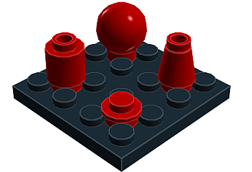

___ Posted June 1, 2013 Posted June 1, 2013 (edited) Illegal combination Do you mean "it is possible, but there is no such combination in no LEGO set" - do I understand it right, please? Because in real LEGO I realy use this combination from time to time...and to show you that it realy works with many possibilities, look at this - my presentation "of the problem": NEW PROBLEM: Bricks 1x1 with round bottom (like #3062, #3957 or even #64230) should connect "inbetween 4 pins matrix" of other bricks, like in real LEGO, like this one here: Edited June 1, 2013 by bublible Quote
Classicsmiley Posted June 1, 2013 Posted June 1, 2013 (edited) Do you mean "it is possible, but there is no such combination in no LEGO set" - do I understand it right, please? Because in real LEGO I realy use this combination from time to time...and to show you that it realy works with many possibilities, look at this - my presentation "of the problem": Image NEW PROBLEM: Bricks 1x1 with round bottom (like #3062, #3957 or even #64230) should connect "inbetween 4 pins matrix" of other bricks, like in real LEGO, like this one here: Image The Technic pin in the 1x1 round is illegal because it stresses the pin; the pin can't "snap" into place. There are lots of part connections that are physically possible, but are classified as illegal by LEGO Design Lab. As for the 1x1 round elements in between studs, you should be able to do that in LDD just fine. Sometimes it takes some patience to get it, but it works. Edited June 1, 2013 by Calabar : Avoid to quote big images from a near post Quote
___ Posted June 1, 2013 Posted June 1, 2013 The Technic pin in the 1x1 round is illegal because it stresses the pin; the pin can't "snap" into place. There are lots of part connections that are physically possible, but are classified as illegal by LEGO Design Lab. As for the 1x1 round elements in between studs, you should be able to do that in LDD just fine. Sometimes it takes some patience to get it, but it works. OK, thanx for explanation...I will be more patient next time and maybe will have luck with "elements in between studs" Quote
___ Posted June 1, 2013 Posted June 1, 2013 As for the 1x1 round elements in between studs, you should be able to do that in LDD just fine. Sometimes it takes some patience to get it, but it works. Agreed: it realy works (after some time I was able to do it, had to zoom in quite enough tho ) Quote
