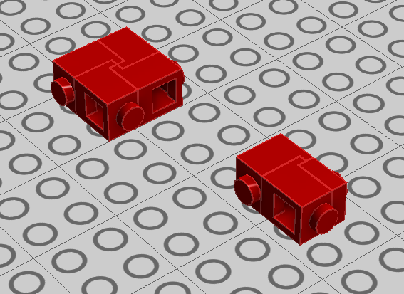

You're right in many ways. I tried to do it with a plain round 1x1 tile but I looked 'odd'. The one I used now is the only one I've in my collection and in my opinion I did a bit the trick, but not completely as you pointed out. The gap in the wardrobe is the result of using an technic pin to invert the bottom and top bricks. I haven't found any solution to remove them while keeping the wardrobe as sleek as it is now. Would love some help on that one because it's a technique that keeps me puzzled and I will need it for sure to have it better under control for further MOCs.
@ Everybody : Greatly thanks for all positive feedback!
I use these:
Aha the secret reveiled! Many thanks...so simple, but so effective, would never found that! Thanks, much appreciated!

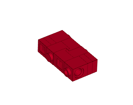

Here's another way how I'd do it - remember that SNOT should always be 2 studs for 5 plates, which means it's cool to have a even number of studs or vice versa, have a number of plates that is divisible by 5. In other cases, you always have a half plate gap to fill, since one stud is 2.5 plates SNOTed. That's why I'd make your closet 2 plates wider and it would look like this:
Lxf file here ...
Notice that the whole wardrobe is in 2 halves, connected only by the bottom white shelve. Also turning the light holding pieces the right way, makes your top red sqares positioned the same distance from each sides. Also notice that the center supporter is not attached to the bottom shelve. If you use the jumper plates in this situation, you'll get a 1/4 plate gap, which is impossible to fill!
It's also possible like Brickdoctor showed you, but those pieces always leave a spare stud or hole especially in small builds. They're cool for inside the walls, where everything gets covered.
