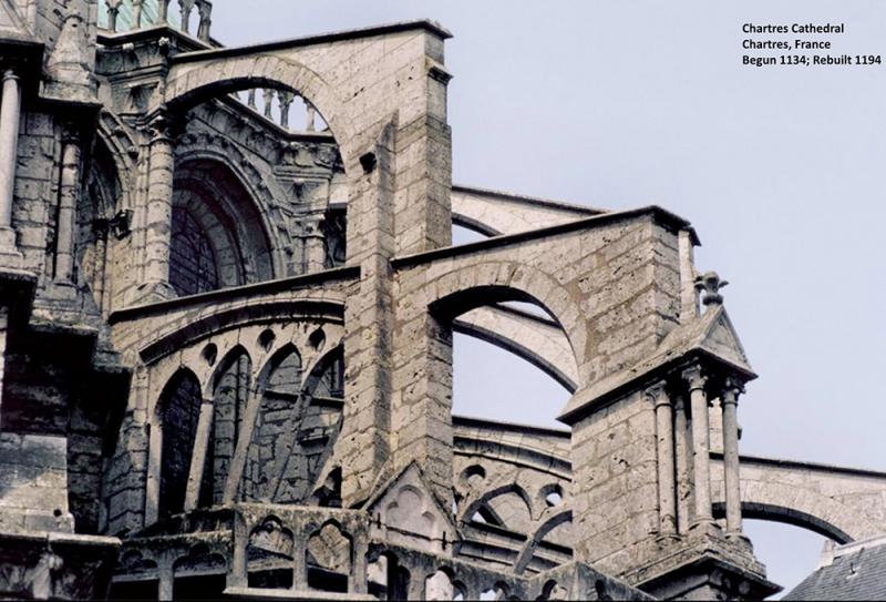

alois Posted November 13, 2013 Posted November 13, 2013 The half arches are exactly right for a gothic cathedral. Flying butresses never had the form of pointed arches. Also, there is a lot of variation in gothic cathedrals (remember, they were built from 1130 till the end of the 16th century). I think the structure is quite right. I would stay with three aisles, not five, since you are already building it in microscale. Quote
Hinckley Posted November 13, 2013 Posted November 13, 2013 The half arches are exactly right for a gothic cathedral. If they were windows it would be wildly inappropriate. As they are now, they look to me like windows. That portion of the facade should have some lancet windows in it. Flying buttresses would transverse the nave. The entrance to the church is the narthex. You can use flying buttresses on the narthex, but that's not common in Gothic architecture. They generally had compound buttressing. If you use flying buttresses on the narthex, they should be outside the buttresses that are transversing the nave. The purpose of the buttressing is to support the wall in order for it to support the stone roof, yet let as much light in through the stain glass windows as possible. Look up Gothic Lux Nova. The facade outside the narthex should rise (for about three registers of large open lancet windows –with full pointed arches– and there should be a false gallery on top) before two ornate and hollow westwerck towers rise above that. The flying buttresses would go over the aisles (which run along the nave) and not touch the facade of the narthex. Right now it looks like the buttressing is part of the facade and that is not how they built Gothic cathedrals. Quote
Martin_B Posted November 13, 2013 Author Posted November 13, 2013 (edited) It's probably not very clear at this early stage, so I can understand why there might be some confusion! The pic in my post above is a cross section view of the choir area from where the crossing will be, towards the apse (there's a lancet window shape in the background, which is where the 'East' end will be). The four rounded arch bricks form the 'flying' bits of the buttress, and although some buildings did use arches of that shape everywhere, I'm planning to build pointed arches for the windows and vaulting as in the later designs. A small detail: the flying buttresses of Cologne are unusual in that there are two rows of vertical supports with shorter curved arches running along the walls, while Notre Dame for instance uses one row of vertical supports with longer arches. I'm going for the Cologne-style arrangement. I'll have some more pieces of the right colours arriving this week, so I can make some progress and hopefully it'll be clearer to you all about how it's going to come together! Edited November 13, 2013 by Martin_B Quote
Hinckley Posted November 14, 2013 Posted November 14, 2013 A small detail: the flying buttresses of Cologne are unusual in that there are two rows of vertical supports with shorter curved arches running along the walls, while Notre Dame for instance uses one row of vertical supports with longer arches. I'm going for the Cologne-style arrangement. I'll have some more pieces of the right colours arriving this week, so I can make some progress and hopefully it'll be clearer to you all about how it's going to come together! As the gothic period progressed they made their flying buttresses crazier and crazier as if to say "look how much this not-wall, can be a not-wall and how much light we can get through it in interesting patterns!" For example, Chartres: As for making everything exactly to the rules, obviously that's not necessary when you're the creator of something. I certainly encourage creativity. For example, gothic architects didn't always stick to the rules. Gothic Flamboyant is one example. But, if you're going to create a gothic cathedral (and Martin, I feel you understand this, I'm just pre-arguing against anyone who thinks I'm giving too specific advice), you should know why everything in a gothic cathedral exists (which Martin, you seem to). Why are there westwerck towers, why are the arches pointed, why is the ambulatory round? Actually, that reminds me, will you have a cloister? But, make whatever shape you want. Break the rules, but you should know the rules first before you break them. Having flying buttresses come off the front of the building would be fine, but if they're buttressing a wall that isn't full of windows, it doesn't make much sense. Learning why architecture that exists is the way it is can really lead to a clearer path for your creativity. Oh, and the gothic architects in Germany were obsessed with the flying buttress, so relative to the Italy, France and the UK, the buttresses will be significantly different. Colognes buttresses are likely a bit nutty just because the German architects loved their buttresses. Quote
