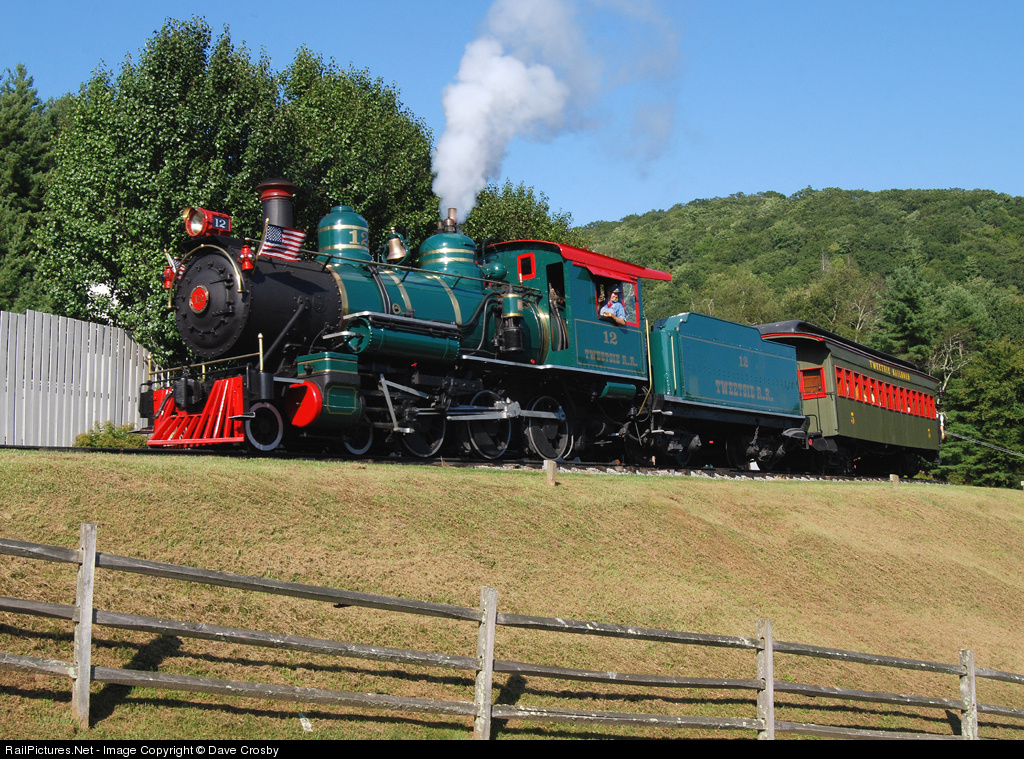

Currently purchasing parts for my first project (more on that later), but starting plan the next one. I am looking to build a narrow gauge steam locomotive and railway with the Indiana Jones track. I am looking at a classic 4-6-0 ten-wheeler, similar to the Lone Ranger Constitution but scaled more to narrow gauge. Ala Walter E. Disney:
or more like Tweetsie No. 12:

I went for a ~6 wide version of "Tweetsie" the last remaining locomotive from the East Tennessee and Western North Carolina Railroad's old 3ft narrow gauge line. Currently it survives in the "Tweetsie Railroad" park in NW hilly NC, so maybe I'll have a chance to ride on it one day. I scaled everything from a pic ala SavatheAggie and also borrowed his boiler design. The loco looks a little oversized on it's wheels for two reasons, One, Tweetsie is a BIG ten-wheeler and is big on its wheels to begin with. Two, I will be using BBB medium drivers, which are bigger than the PF wheels currently in the model.

Hey Man, when do you intend on completing the project? and when you do, when do you suppose on showing photos of the completed thing? I actually made Tweetsie #12, but it's in standard Lego gauge. It looks okay, not nearly as good as yours. (I actually live an hour and a half from the real Tweetsie) although I have some suggestions, first up, the spacing between the front of the smokebox and the smokebox itself needs to be filled in if not moved in. and number 2, change the smokebox door from the red color to black or dark grey, and if so desired, change the smooth stud representing the number plate to red. mine is gold like yours. other than that, well done.

As for the smokebox spacings, you are correct. The above rendering is of my poor LDD skills. In my real life model that radar dish sits back 1 stud further and flush with the smokebox (so it looks like how you describe). I scaled the model from an engineering drawing and it's as close to proportions as possible.
