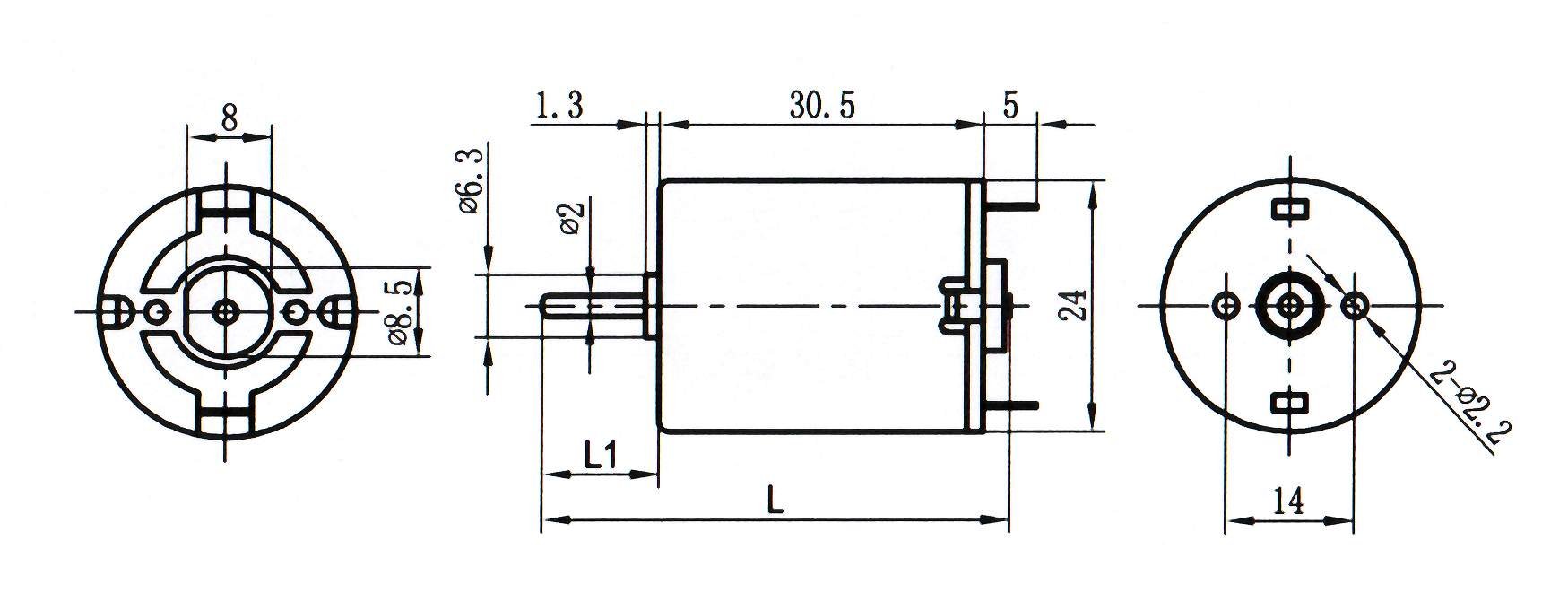

T_Tank Posted May 27, 2014 Posted May 27, 2014 (edited) think you can combine this http://www.bricklink...tem.asp?P=92906 with that http://www.bricklink...tem.asp?P=6538c? but only for 1 studs worth of axle inside? Also... thinking about the rc motor but it needs a REAL rc motor like a 240-380 can sized motor compared to the rather small one inside.. Would need to have internal gears that are a gear pitch common in the rc hobby world.. 240motors are 24mm in diameter 380 are 38mm in diameter bolt patterns if memory serves me right are 12mm and 14mm spacing from hole to hole on the motors Edited May 27, 2014 by T_Tank Quote
efferman Posted May 27, 2014 Author Posted May 27, 2014 the cv joint part is no problem. and the other part, you want simply a motormount or a motormount with a gearbox? Quote
T_Tank Posted May 27, 2014 Posted May 27, 2014 Was thinking a gearbox of some kind similar to how the buggy motor is but with a larger motor on the end I'd go with the 24mm sized motor to start with http://i00.i.aliimg.com/img/pb/067/527/333/333527067_338.JPG which would use a 48p gear. For meshing I'd go with something that allows one side of the motor to slide further into or off of the spur gear. At least 3 to 4 gears should be used in the gear box not including the pinion gear so we can have enough clearance to run a axle under the 24mm diameter from the output of the gear box. also might need to throw some metal into the mix in the form of bushings or bearings of some kind in metric Hope this isn't to much to ask for Quote
efferman Posted May 27, 2014 Author Posted May 27, 2014 i think the gearbox for a motor like this is a bit to much for my abilitys in making gears. Ozshan has me contacted that the helical gears of the torsen diff not work under load Quote
