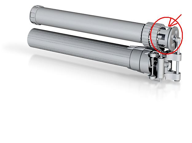

bonox Posted April 16, 2015 Posted April 16, 2015 update: the axle pins work very well - better in fact than notched 2L axles. Had to use two 20t bevels to drive though, or it kept skipping. Thanks efferman; it works but probably requires too much work for a large audience though.... I'd suggest making the thread tolerances quite a bit larger. I recall from one of their documents the FNS material has a 0.2mm resolution - the shrinkage is probably greater than that. The end cap that holds the planetary gears also had most of the tangs broken when mine was delivered. Perhaps a small redesign or some sprue to support them in transit? Quote
efferman Posted April 18, 2015 Author Posted April 18, 2015 Thanks for feedback. some things are broken? do you have a picture of it? Quote
bonox Posted April 19, 2015 Posted April 19, 2015 (edited) Thanks for feedback. some things are broken? do you have a picture of it? I've glued the cap to the case now, so it's not obvious. The cap with the six tangs (red arrow) that exist to stop it twisting around the shaft had a few of those tangs broken. The part was placed diagonally across a zip-loc bag. The bag was probably a bit small and when closed, squashed the end cap up against the shaft and clutch rings. I guess it moved sideways and snapped some of the thin walled tangs. I bought the two major parts seperately (one black one white). I don't know if you would get the same issue with the version that has all the parts connected. My only other comment would be that while I think it's ok as is, I would prefer to pay a little more for a doubling of the wall thickness of the extending portion of the unit (what would normally be the polished shaft attached to the piston). Given the repeated cleaning, assembling and remachining, making this bit a little more resistant to handling damage would be well worth another dollar or few. Edited April 19, 2015 by bonox Quote
