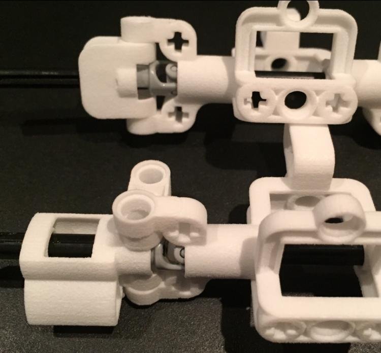

Today I received my mini front drive axle and mini portal axle.
Is there something I do wrong, or is there an 1 stud error in the design? The turning point of the hubs and CV joints is 1 stud away from each other.

The parts are not designed für universal joints. Do you have tried the cv joints with the dark grey part on the wheel side?
Ok I see. I have tried the CV joints and they fit. One big disadvantage of these CV joints is the very small steering angle. I had hoped that this was not an issue with your front axles, but it still is.

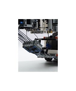

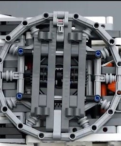

I am currently building J Ottens LTM11200 Have you had any experience with anybody asking about your turntable that might solve the problem of not it turning 360 with out help.Has any one used your large turntable for this  MOC
i would like to use 2 of your large actuators for the rise boom function what are the max load the actuator can take
many thanks dean

Hi efferman
2kgs with one actuator is good news
The turntable is 17 across in diameter and weight of superstructure and boom I think is about 4kgs I read somewhere
best regards dean
24 minutes ago, efferman said:
then you can use the one with 17 studs diameter
Hi efferman
sorry I should have read the thread from the start as I did find your 17 turntable
would you recommend to use 4 wheel holders for the weight 4+ kg  of this structure and boom?

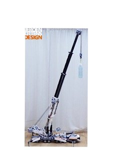

have you had any experience in making a crane boom extend and the system that you would use
as this MOC is using a string/winch purchase system to extend the boom
as the normal Lego system would make the boom too heavy as now the 4 section boom is about 2.5 meters fully extended
have you had any ideas about a system that would be different and better than perverse systems.
many thanks dean
10 minutes ago, efferman said:
Four wheelholders are highly recommended, and for the boom extend mechanism, use @Jeroen Ottens system, he knows what he is doing.

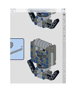

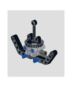

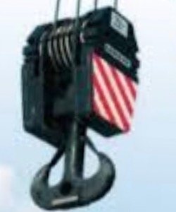

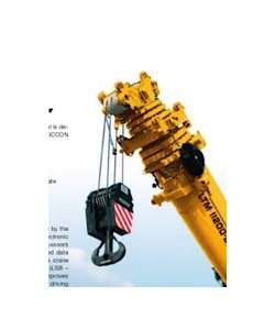

Hi efferman
I’ve seen on your shapeways page you’ve designed some crane hooks could you design one for j Ottens moc?
Plastics would work for the build
best regards dean
i guess it is done, when between the holes on the turntables is a distance like a liftarm 6? https://www.shapeways.com/product/TRVQMMSW7/hook-for-jeroen-ottens-ltm-11200
Metal parts i will not make
Perfect thank you
your work is excellent
any chance you could design the housing that holds hook and the pulleys ?
Kind regards dean
