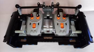

teos Posted January 24, 2017 Posted January 24, 2017 I wanted to verify something about efferman's mod before I start the upgrade. After reviewing the instruction guide(pdf) it appears that there is a medium motor instead of a servo. Is that correct or did I overlook an important detail? Thanks! P.S. I did notice that the picture of the parts list has a m-motor too. Quote
efferman Posted January 24, 2017 Author Posted January 24, 2017 this is correct. the servo not used in the volvo when you have done the mod Quote
teos Posted January 24, 2017 Posted January 24, 2017 Excellent. After today's mail I should have all the parts to build the saddletrac and complete your steering mod to this set. Quote
Jon61 Posted March 5, 2017 Posted March 5, 2017 (edited) I was given my first ever Technic kit (42056 Porsche) for Christmas - I've not played with Lego since I was a kid which was way before Technic was invented. I really enjoyed building and tinkering with 42056, so as a second set I got 42030, particularly for the PF components. For my first post here, therefore, I thought I'd offer this very simple mod for the 42030 B model. It addresses what Sariel in his review called the 'Gear That Does Nothing™': I know it was meant to represent something on the real vehicle (an air filer perhaps?), but it did seem a bit odd. So it now does something - it opens the hood. The simple changes only use parts leftover from building the B model: 1-3: Under the hood, the yellow angled connector #5 is exchanged for a black angled connector #6, then extended below with a 2L pin, connector #1, DBG 3L pin/axle and a black 2L round pin connector. 4-5: the blue 2L axle pin holding the gear is exchanged for a 3L axle and (after inserting the axle through the existing black 2L lftarm, not shown in this picture) one of the leftover black 9L bent (7-3) liftarms is added as shown. This is the end result, shown after turning the gear to open the hood - fortuitously the notch in the #3 panel is just at the right place to latch the hood open : And, if I can successfully link to a video here, this is the mod in action (I hope this works): Edited June 28, 2021 by Jon61 reinstated photos & video lost from Photobucket Quote
