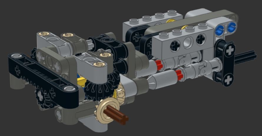

keymaker Posted April 28, 2019 Posted April 28, 2019 Hi, I wish to ask you for help in my new project. I am trying to build solid and small floating front axle. Scale is quite small (1:23) so I came across many problems. I have cheked the whole thread, I also looks inspirations elsewere, but without success. Maybe some of you have some idea how to resolve this task. I appreciate all the help. Goals: - 9 studs wide (11 beetween edges of the wheels) - 56 x 26 baloon tires are in use - min 2 stud clearance - steered - floating solid axle (there is plan to use or shock absorbers or hose, soft axles) - no differential Some of my tries (prototypes) are visible below. But I am still not sure of them, one is quite flimsy (the first photo and the first on the left on second photo), otherone requires a lot of torque for drive (second photo, this one in the middle) or steering (second photo, the last one). After my tries I think that using of CV joints will be better that universal joint. It gives some relief (and better geometry) for steering due to lack of differential. For drive I think that combination of 12 and 20 tooth bevel gears will be good compromise between speed and torque (and it looks nice). Quote

keymaker Posted April 28, 2019 Posted April 28, 2019 (edited) @Zerobricks I have just built it. Solid idea, just like mine the middle one from second photo, but different steering mechanizm (but the same angle needed to perform full turn). Unfortunatelly it is impossible to build exactly like showed because thin L-shaped lifearm 3x3 blocks 12 tooth bevel gear. @sirslayer Thank you for proposition, but it does not meet the goals of the project. It is too wide, it has the differential and it limits the clearance to only one stud. Edited April 28, 2019 by keymaker Quote
sirslayer Posted April 28, 2019 Posted April 28, 2019 if you take out the diff and add a home made portal hub, it can meet your requirements. the pivot point is closer 1 L in length Quote
keymaker Posted April 28, 2019 Posted April 28, 2019 @sirslayer this part is a nice part, but I do not have an idea how to use it and still to keep the 2 stud clearance and steering possibility at the same time. Quote
sirslayer Posted April 28, 2019 Posted April 28, 2019 (edited) I know what you mean... :) .. its 2 l clearence till 2 l from wheel... is the only down side the 49.5mm tire on the right side requires extra support Edited April 28, 2019 by sirslayer Quote
sirslayer Posted April 28, 2019 Posted April 28, 2019 (edited) @keymaker this is closer to your required specs, this design requires a stabilizer front steering bar and rear steering bar not shown.. This gives you better steering angles (tighter turns).. its almost built the same from previous pictures. Edited April 28, 2019 by sirslayer Quote
sirslayer Posted April 29, 2019 Posted April 29, 2019 and believe it or not!!! A llittle bit of negitive camber improves grip when cornering... https://en.wikipedia.org/wiki/Camber_angle Quote
sirslayer Posted April 29, 2019 Posted April 29, 2019 I got it.... Using the Pin Connector 3L with 2 Pins and Center Hole, I think this design will fit the bill.. Quote
keymaker Posted April 29, 2019 Posted April 29, 2019 Ha! It looks like you have found the way to use this part and still meet the goals! :D This is something new compared to previous propositions, thank you, I will check it out today. Quote
