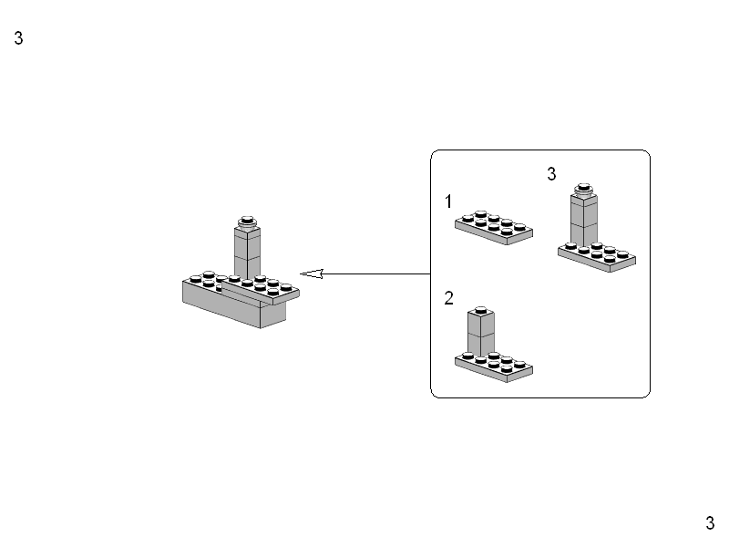

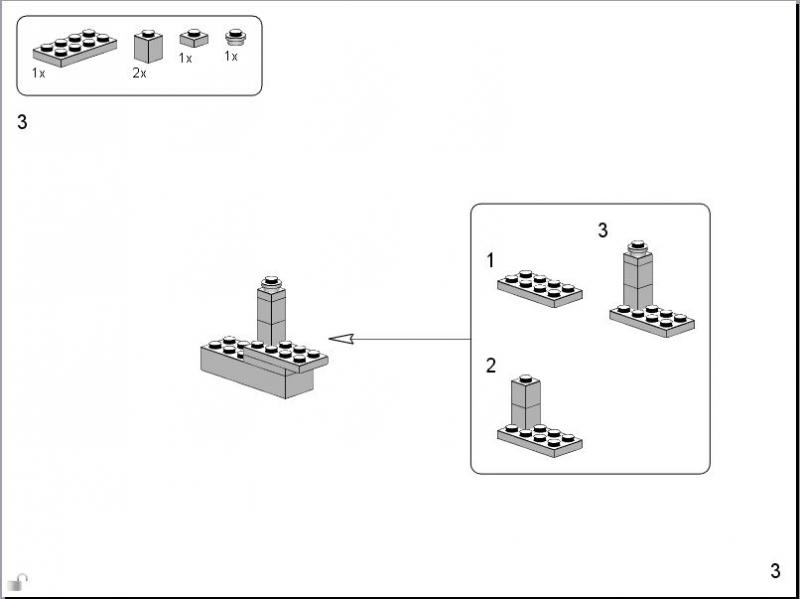

September 11, 20168 yr First, I would like to say thank you, Jarema. Your program is very beautiful. I have 2 questions though: 1. I would like to print the instructions out, which requires higher resolution than the default 800*600 to meet the 300 DPI printing criteria. And I know I can "change page size and resolution". But the problem is every elements in it does not enlarge automatically with the higher resolution.One solution is to change the default CSI/PLS scale from the template. But after it's done, every part list in the instruction does become larger. The problem is the pens enclosing the part lists don't get bigger accordingly. Do I have to manually adjust every pen? 2. After I convert a submodel into a callout, the part list for the submodel is gone. So how can I show the part list of a callout? Thank you so much.

September 17, 20168 yr This https://github.com/remig/lic is new repository for LEGO Instruction Creator (know as LIC or LICreator). Tell me if this error still exist. Thanks for the fast reply. Yes, I am using the latest version(3.0). The problem is the same. Could it be because of the errors in the log file? ERROR: 2016-09-17 12:01:09,723: Uncaught Root Exception: Traceback (most recent call last): File "F:\Workspace\eclipse\licreator\build\licreator\out00-PYZ.pyz\LicTreeModel", line 135, in index File "F:\Workspace\eclipse\licreator\build\licreator\out00-PYZ.pyz\LicTreeModel", line 536, in child IndexError: list index out of range INFO: 2016-09-17 12:01:09,723: ------------------------------------------------------ As I said, no part list for the callout. Thank you :)
September 17, 20168 yr Why you see is not error. It is only one list, part list per step. Callout not inherit of this. I do not see parts list. You deleted it.
September 21, 20168 yr Oh, actually I didn't delete anything, what you see in the picture I posted is what I got in the first place in its original form. I understand that you thought a part list for every step within a callout is unnecessary, which I agree, but what I am talking about missing is the whole part list for the entire callout. Now I am sure it is a bug, because I have found a way to circumvent it :-) Here is what I do: 1. convert submodel to callout 2. click then right-click on any part in the call out, then select any part or "select all" 3. choose "remove from PLI" 4. repeat step 2 5. choose "add to PLI" Wala! the PLI shows now! It is my hope that you could find why this is happening to me, if it's not happening to everyone. But if you couldn't, it is really OK. And I am as grateful as always using you amazing program:-) Edited September 21, 20168 yr by Arcquinn
