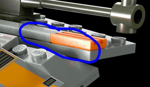

Looking at the picture you posted earlier it looks like only one of the vertexes in each triangle are being displaced from the surface, the others remain on the surface itself. This is most obvious on the one that forms the bottom of the L; you can clearly see the left-hand end raised up, whilst the right-hand end is level with the surface.
I'm not familiar with your software packages but my instincts would be telling me to:
  • Look at the surface normals for the vertexes to check that they're facing the correct direction.
  • Ordering of vertexes might be important in order to determine forward or backwards facing and the order that your package expects might not match what the original source provides.
FIXED! But I can't set separate roundings for the bricks and logo. It should have a less rounding to look less bumped and more displaced. Well. Better than nothing.

Pretty nice! What was the problem?
I am importing with a script what is using a cleanup. If I don't use the cleanup the mesh has bad normals and flpped polygons. The problem was that the basic measure for the import is set to 0.05 what is perfect for the real scale in MODO but I have to set it to 0.1 to prevent that the cleanup will merge close points and destroy the small scale LEGO model.
OK. I replaced the studs with the beveled ones but it looks like they are just available in low-res. And the top will be interpolated smooth and not flat. A pre-bevel of the studs had been fine to adjust the rest of the models with a thinner edge what is better for the LEGO logo. The LEGO logo model is anyway a bit too bold compared to the real ones *:-)

OK. I replaced the studs with the beveled ones but it looks like they are just available in low-res. A pre-bevel of the studs had been fine to adjust the rest of the models with a thinner edge what is better for the LEGO logo.
Well, only the low resolution of the regular angular stud exist too, so it must have been substituted with a true cylinder at some time in the LDraw -> MODO conversion. Since the beveled stud can be easily defined mathematically (cyinder+torus+disk) it should be possible to get a non-facetized render.
This is a more tricky issue, but I think it should vanish if you use a higher resolution torus.

Only major issue now is the greenish dark grey color that was pointed out earlier. Should be a cleaner dark grey without the green tint.
Also the surfaces of the bricks should generally be a bit more very glossy and clean, without so much roughness. see attached image
Besides that...great to watch the progress :classic:
The roughness is a result of low samples atm. I will check the greenish grey later. Next steps - when I worked out the perfect method to import the models I will work on two shader: one for the edges adding scratches and bumps and one for the faces adding very subtle scratches and bump to make the faces looking more imperfect. Lot of work to do.
