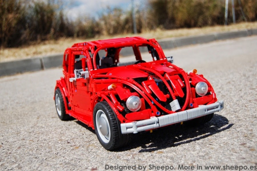

Here is my lastest car. The classic Volkswagen Beetle, officialy called Type 1, or informally in some places around the world the VW Bug.
This car received a lot of modifcations and improvements along the years, I have built the 1967 model.
This car is made in scale 1:7.8. The total size is: 65 studs of length, only 25 wide and 23 of high (50x20x18 cm)
The weight is 2.5 kgs, with around 3000 parts and 5 motors.
As always it includes some remote controlled functions:
- Steering (M motor)
- Drive (2 XL motors)
- Sequential gearbox (PF Servo motor)
- Brakes (M motor)

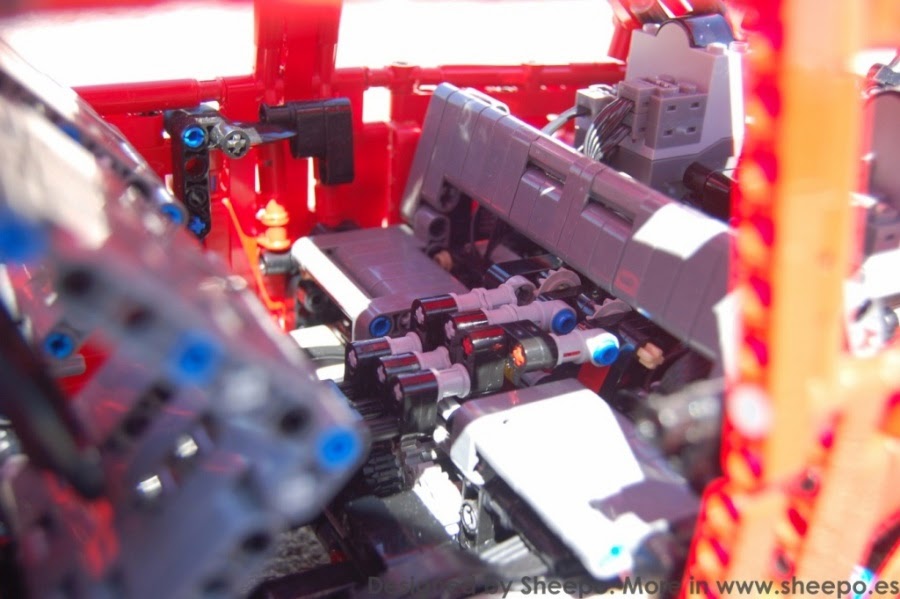

The sequential gearbox is a modified version of the Mustang's gearbox (3rd Gen V2), with 4+N+R speeds and as always with auto-clutch.
The speeds ratio:
R - 1.25:1
1 - 1.25:1
2 - 1:1
3 - 1:1.33
4 - 1:1.67
The max speed in 4th speed is 4 kph (~2.5 mph)

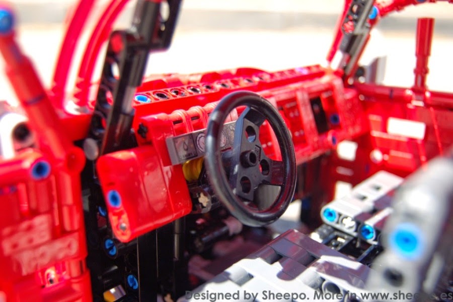

It has a gear indicator in the interior, between the front seats.

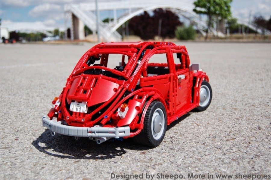

Boxer-4 fake engine under the rear bonnet.
The bodywork
Also you can disassembly the bodywork removing only 5 pins, do it is very easy and fast.
A complete bodywork with openable doors, front trunk bonnet and and rear engine door.
Also the doors have lock, you need turn the door handle to open it.

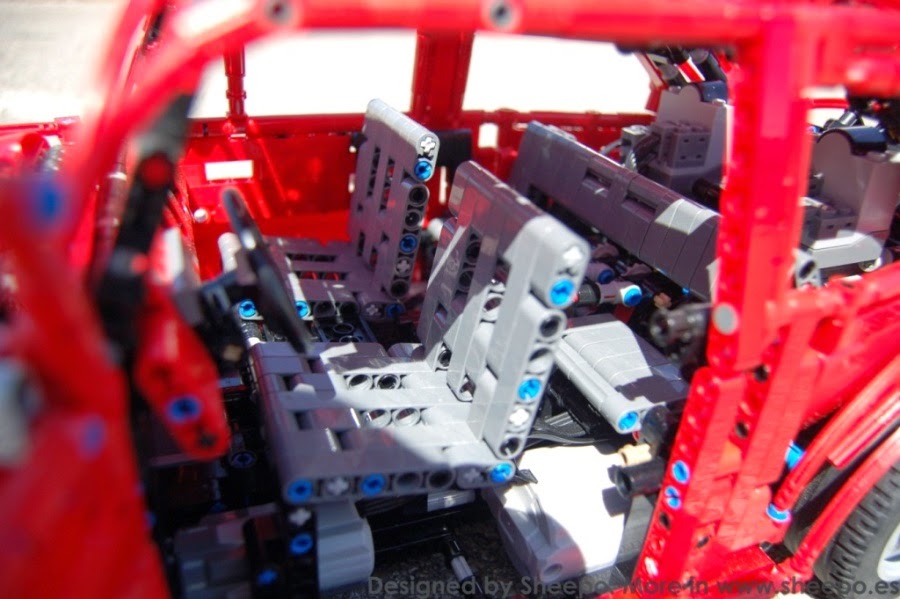

It has 4 full size seats and folding front seats.

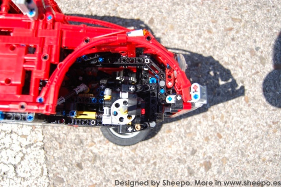

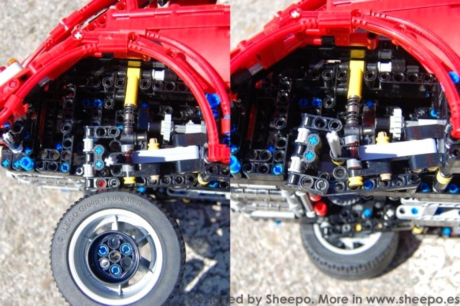

The suspension is based in the real one: front rigid beam independent suspension axle and rear swing axle.
Also the front axle has stabilizer bar.
The steering has ackerman geometry and working steering wheel.
The car also has working brakes in all wheels: disc brakes in the fron and drum brakes in the rear.
In addition it includes functional brake pedal.

Great replica of a vw beetle,you made a fantastic job of the styling. :classic:

@Sheepo - Great work once again. :thumbup: It is instantly recognizable and I like all the features that you have put into this, and especially how you have kept the rear suspension true to the original.
I was really hoping to see that you would model the original suspension, glad to see that you did! I would love instructions for just the gearbox, are they available?

Awesome! Always wondered how to do drum brakes.
The brakes are the same used un my forgotten Petebilt. But with mechanical actuation instead of pneumatic :)
My favourite car, now in Lego. I've always wanted to build one but the lines of the body have been to hard to replicate, for me anyway. This is fantastic, and has all the details of a '67. I must commend you.
