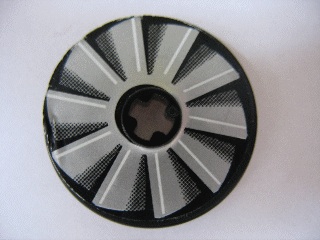

Bring it into this century of aviation, design some nice jet engines with these:
Much better thrust to weight ratio :)
would it generate enough thrust ? ( its only like 3 studs in diameter, a larger version would be required)
you could stack them and offset them for more thrust.
More like millions of rpm because its a sticker :sceptic:
