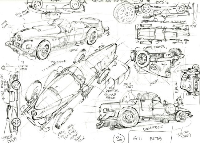

This post is kind of one and a half MoCs... the Morgan is actually my second attempt at such; the first was a freelance car I called the
I used the RC motor because it was fast, and I had one. I used conventional RC equipment because I don't like the tradeoffs made on either of the PF controllers, and I wanted a bigger rechargeable battery. The GT1 drove well, but the unconventional suspension setup took up a ton of space, leaving the electronics hanging out and the trim hanging by just a couple studs... the exposed drive train also broke at least two old 16T gears.
Thus, I built this car in response to those issues. The prototype is a 1935 Morgan Super Sports; I didn't try to model it exactly, rather, to save on parts and weight, I tried to outline it in the way that 80s and 90s Technic outlines vehicles, and I think it worked out pretty well. The hardest bit was probably suggesting that the body ends in a circle, which still doesn't quite come across.
