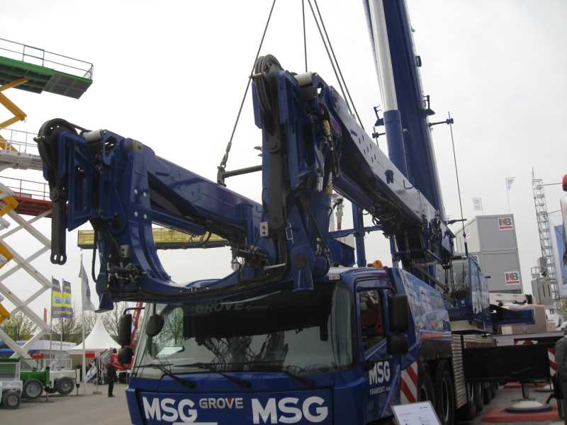

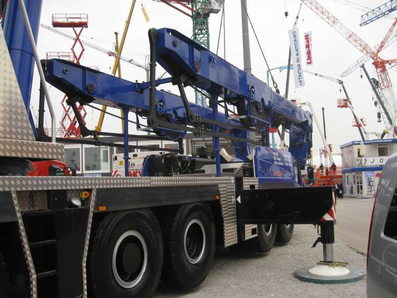

I've made this monster crane with a few changes. The wheels and steering aren't motorized and it's not IR controlled. I've made a custom box with 6 toggle switches and I've used a old sub D cable to power the crane. Instead of 2 L12 actuators I used a single L16. It's a beast of technic model, perhaps even to big. The outriggers are way to weak to push the crane up and the crane needs a lot of counter weight so that is stil a work in progress. But I had lots of fun with it and I'm going to keep improving it until I'm satisfied. Thanks to everybody who helped create this, you are all insane... but the kind of insane I like ;-)
@ Colonelprca:
That is awesome! I have been thinking about a Y-guying system when i build mine as well - how did you make the string system on the Y-guying? is there a hidden winch somewhere?
Hi Colonelprca
That's very impressive and looks fabulous.
Have you any closeups on your attachments to the boom please? It looks like you've got pneumatics in there.
Also looks like you're using efferman's large actuator like me - what do you think of it?
