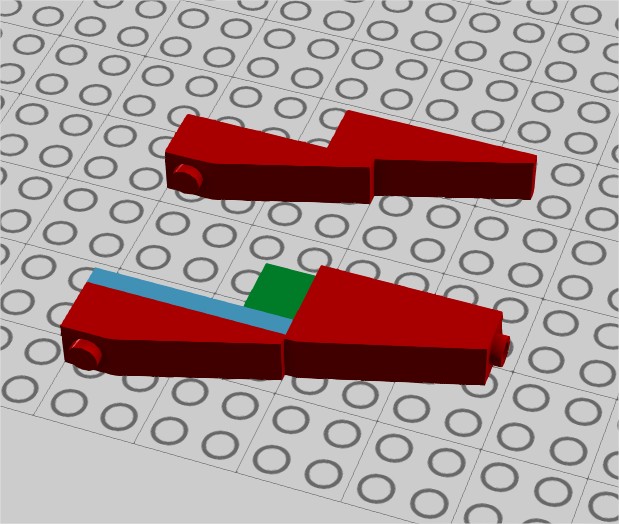

The connection isn't "illegal" because the pin doesn't snap/isn't secure (at all), but because it basically ruins the part over time, so I'd say the bottom one.
Since there is a bar through the pin, keeping the prongs expanded, wouldn't that overcome the detriment of it being compress?
As for improvements, my only problem with your design would be the ends of the wings, which are very "steppy". Have you considered making that side of the wing fully flat by rotating the whole wing itself?
As to force a perspective that the slopes appears linear than what it actually is?
Nope since it has no room to expand (I wonder if such a round brick with room for pins would be technically doable, probably not).
I was inserting pins in round bricks all the time when I was a kid, eventually they wouldn't pin anymore, not that I really cared about rules back then.
Only to have the wings less steppy, whatever the mean. Of course another way is to use plates, I'm not sure what's worse, studs or steppy slopes.
Oh, I see, since the clearance of the Technic pin is slightly wider than the diameter of a bar.
Some of the cheese slopes delineating the gun housing have to be offset by a half plate so that the stacked slopes as a whole are linear, and that is only possible with modified bricks and brackets. I have tried to integrate plates into the setup, but that has been unsuccessful and clunky.
There is this other slope 2744.t1.png (2744), and when stacked it is linear, but unfortunately, the Technic holes…

I think that if you use this slope instead it would be less steppy, but that would mean redesigning the whole wings and also I'm not sure if the angle would be right.
Indeed it is less steppy, and sure would require a considerably amount of redesigning, though will not work so well with how thick it is
It can work, though the angle won't end at the front in a nice point, as you say.
Very nice model, by the way! :classic:
While it works better because the steps are parallel to the other axis, it's still steppy though.
I didn't know about part 2744, seems interesting.
Otherwise there's a combination of both, which has a "cut" instead of a "step", & is only better because it preserves the line.
If you managed to adapt the first slope here, it'd look much better. Note that it doesn't work in the LDD because the 1x2 slope snaps to half studs, but that's only in the LDD.
Thanks! Your T-47 is what inspired me fashion mine with brick built wings.
About the nice point at the front, that is what I was trying to find the words to say. To elaborate why it was not possible to manage using that sloped brick resulted from finding a new solution for the nose, which is similar to Lars' original design, but does not involve partial connections, and that ultimately required a finer point so that the wings align up with the nose smoothly as possible with minimal gaps and rough edges.
*snip*
Though the issue remains present of how to keep the line linear at the end of the 4 x 1 sloped brick?
*snip*
For the 18º slope, the piece in the middle will need to be connected, and that seems it could be done with a 99206 modified plate, but the problem being that it is a 2 x 2. Do you have any ideas of how it could connected otherwise?
Edited by LiLmeFromDaFuture
well yes, using a 47905. So you'd have to manage to attach a stud for the middle slope, & antistuds for the 2 others, which could be tricky.
